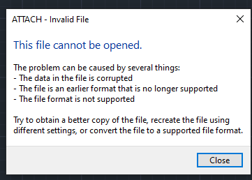

Has anyone successfully been able to export Orthos out of Site Scan Manager and import/attach them to an AutoCAD DWG?  Every image we try to attach in AutoCAD we get the following error:

We still haven't successfully been able to import any of our imagery generated in Site Scan to AutoCAD.  SiteScan exports the ortho imagery out as a GeoTIFF (no world file.  The spatial info is embedded in the TIFF itself).  When we try to import it into any flavor of autoCAD, we get the errors mentioned above.  We have no problems adding the GeoTIFF's into ArcGIS Pro or ArcMap.

We export the orthos out of Site Scan to our network file system.  By default they come from site scan as a geotiff.  Our CAD team then attempts to load the orthos in using either ATTACH or MAPIINSERT and it fails with the errors I show above.  They have tried with the orthos on the local machine and they get the same error.
