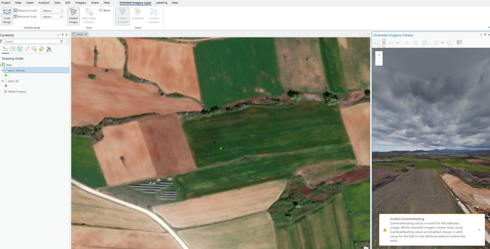

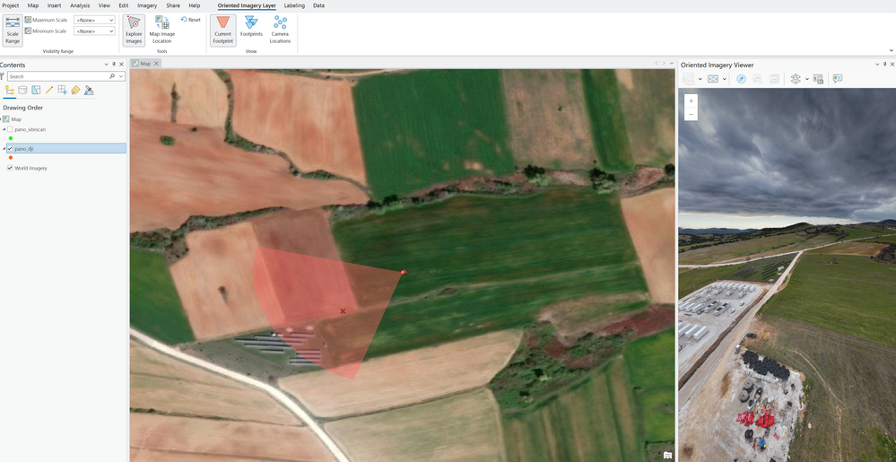

msmpokos
Hello @NicoBonnafoux and thank you for your reply.
The issue is specifically related to missing camera orientation metadata required for Oriented Imagery in ArcGIS. While SiteScan panoramas include GPS and projection info, they do not contain a valid heading value.As a result, when these images are added to an Oriented Imagery dataset, the system reports "Camera Heading value is invalid for the selected image. All the oriented imagery viewer tools using CameraHeading value are disabled."
In contrast, DJI processed panoramas from the same mission work correctly because they include orientation metadata.

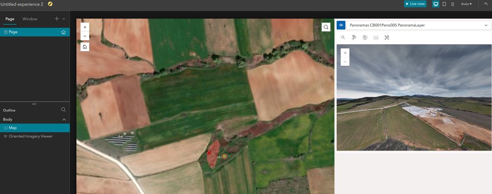

We also just added the ability to publish360º panos directly from Site Scan to ArcGIS Online, have you tried this?
msmpokos
Hello @NicoBonnafoux thank you and i am looking forward for your reply.
As for the ability to publish 360º panos directly from Site Scan to ArcGIS Online, we have tried ti but unfortunately would not work for our use case for several reasons:
1) We need a single oriented imagery dataset that contains all the panos, not separate datasets per flight.
2) This functionality is not yet available in ArcGIS Enterprise, which we use
3) In the generated oriented imagery, the footprints are incorrect:
