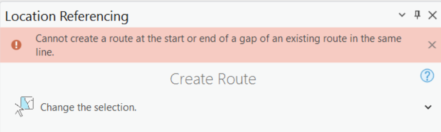

However, when I digitized a new centerline from the end of route 94 to the beginning of route 96, and tried to Create Route from it I got an error of:
Cannot create a route at the start or end of a gap of an existing route in the same line.
