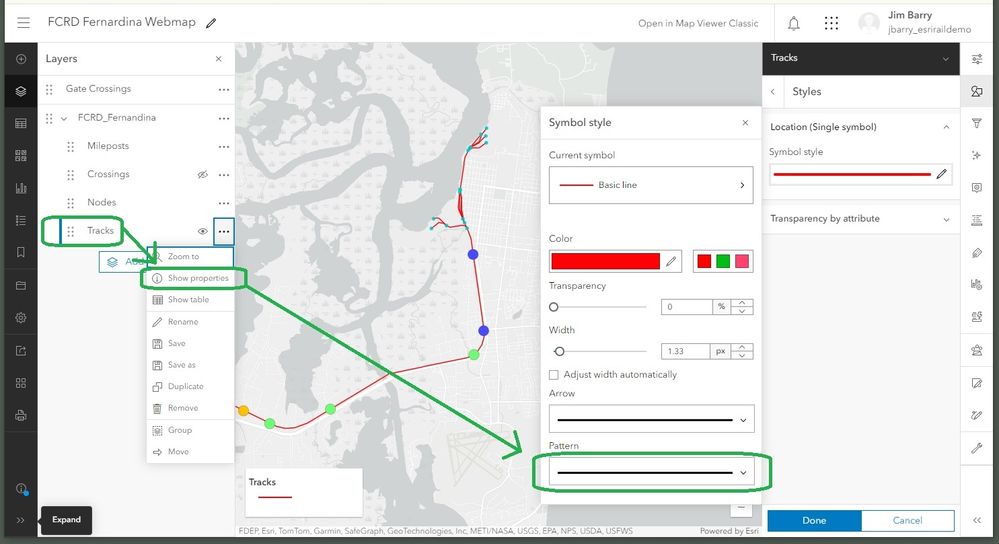

First, let's see what the ArcGIS Online Map Viewer has. When you are choosing a line style for your railroad tracks layer, it will look something like this:
arcgis online line symbol optionsarcgis online line symbol options
In the Layers view on the left tool bar, you would click "Show properties" on the Tracks layer, then drill in on the right panel to get to the "Symbol style" popup panel. Then at the bottom of this panel is a pull-down option for "Pattern". If you click that open, you'll see a small variety of solid, dotted, and dashed line symbols, but there are no options that provide any of the typical "railroad" type of line symbols, that draw with either a single or double line, with periodic perpendicular hash marks.

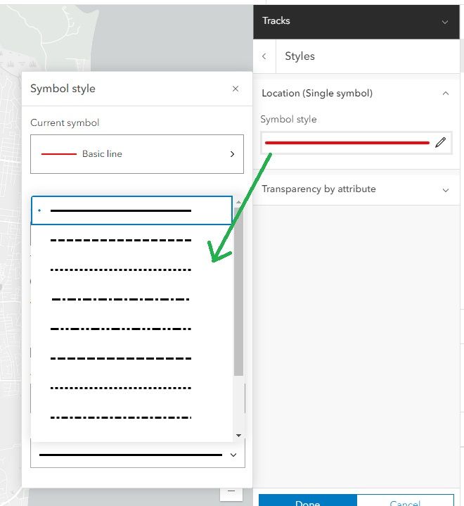

solid, dotted, dash line patternssolid, dotted, dash line patterns
As it turns out, just because the railroad line symbol we want to use isn't choosable through the popup panel doesn't mean that the web map doesn't support it. Here I'd like to describe a technique for using railroad symbols in an online web map.

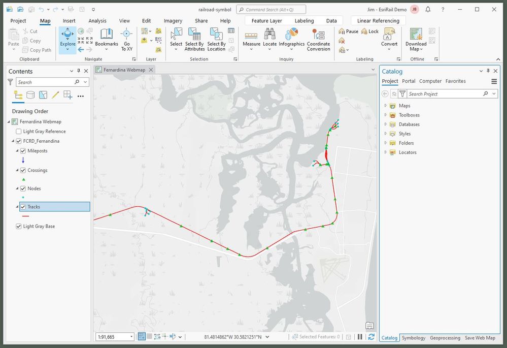

Check your Windows Downloads folder to find a new file called "item.pitemx", or something similar. Check the date/time stamp to ensure you're working with the correct one. Double-click this file, which will open your web map in ArcGIS Pro.
And this is what your web map will look like in ArcGIS Pro.
web map opened in proweb map opened in pro

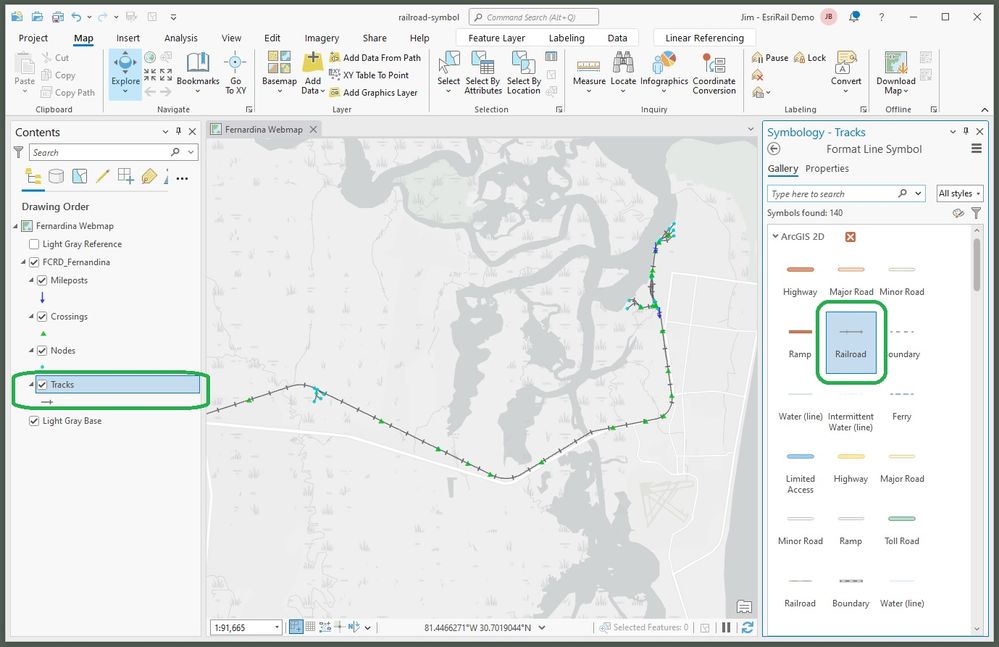

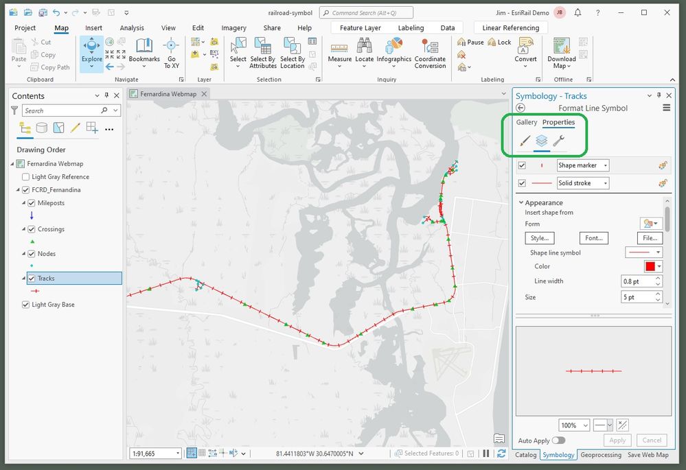

Now that your online web map is open in ArcGIS Pro, go ahead and change the symbology of the track layer to use the Railroad symbol. The default color is gray, and it has a default thickness, and default length of the hash lines.
choose railroad symbolchoose railroad symbol
But in the Symbology pane, you can toggle over to the "Properties" tab (in green below) to change the color, length, and width of the track lines and the hash lines. Totally up to you. As you can see, there are many other symbol settings you can add, remove, change, and control, but we'll move on.
advanced symbols in proadvanced symbols in pro

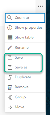

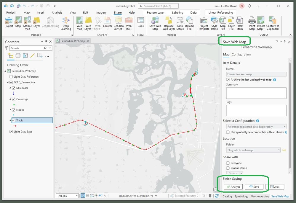

Let's save these symbology settings back to the online web map. To do this, go up to the ribbon's "Share" tab, and click the tool called "Save Web Map", and when prompted in the popup dialog, click "Save web map" again, like this:
save web mapsave web map
This will open the "Save Web Map" tool pane. Fill it out as you see fit, and when you're ready, click "Analyze", and then "Save". If clicking "Analyze" creates errors or warnings, you will need to sort those out, depending on what they are.
analyze and save web mapanalyze and save web map

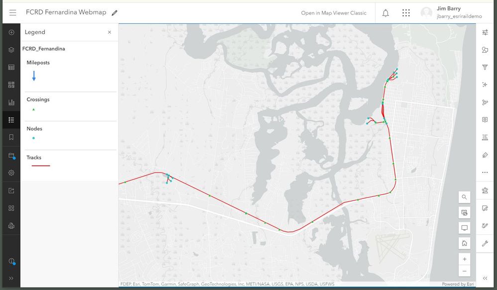

Once the "Save Web Map" tool works successfully, go back to your web map, back in the ArcGIS Online Map Viewer, and you'll see that the railroad line symbol you setup looks the way you configured it back in ArcGIS Pro.  The changes may not appear automatically.  You will need to refresh your browser, or close and reopen the web map.
Additionally, if you want to modify the railroad line symbol some more, you can. If you open up the layer's "Properties > Styles" pane again, you'll see options for resetting the properties for both parts of the line symbol: the "solid stroke" and the "vector marker".  These symbol setting options were not available before.  They only become visible after you use ArcGIS Pro to change the line symbol, in this case, to a railroad symbol that uses both a line and a marker.
