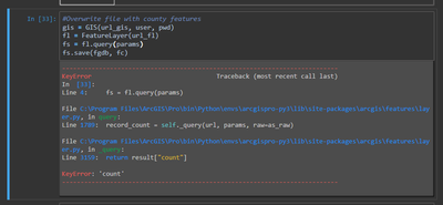

KoriKurtzeborn
Hi Josh! Hoping to troubleshoot an error I'm getting in the query portion of my code. I think because of the number of features. Any tips on how I can adjust my code to accommodate the size of the feature layer I'm trying to download. The error I get is KeyError: 'count'
