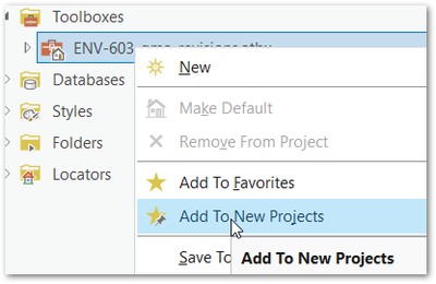

High value scripts can be added to a project toolbox and then "Add to New Projects" and be always at finger tips. What about things that are less polished? Something that does useful work but the doesn't warrant the overhead of adding parameters and tool validation etc. to make it a 'tool'.
