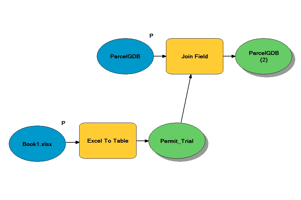

I am using model builder to join the excel table I have with a parcel layer based on an ID field. However, every time I update my excel file and re-run the tool the data doesn't overwrite what was already in the parcel table. it just adds all of the fields to it again.
Do I need to pull it out to python and add an overwrite function or is there a easy tool I can just drag into model builder to overwrite what is in the table. Please give a little insight of what is my best practiceExport Graphic.jpg

remove the old join and rejoin the new. Given that you are updating this all the time, it is pointless to make the join permanent except for backup purposes... but who needs a model for that

I made a few changes and actually got it to work. This is the new model I made to make it work. I need the Remove Join so the parcel table didn't have the same info joined to it every time I joined the new excel file. Export Graphic.jpg

Abdullah, so if I don't remove the join my parcel layer will still be looking at my old excel table for the information and will still have the joined data associated with it. Once I remove the join my parcels will be back to just there original information. then from there I can rejoin the parcels to new information as it come up.

You would get an error if the join wasn't removed, ... you remove the join, update the information  and it can be rejoined with new information when the need arises.
