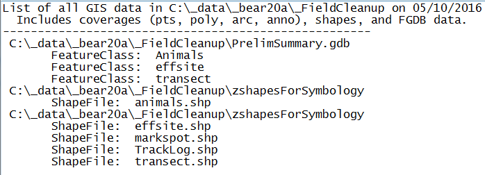

Are you saying all three output files end up blank?  I just downloaded and ran it (second button...first only shows databases, not mxd data)  against a folder  that I created in the last few days (i.e., not the computer or folder I created and tested the addin on originally) I had two mxd it, and all three files were populated. For example, the .txt file showed...

Yes, all outputs were blank. I opened the csv and it is blank also.
