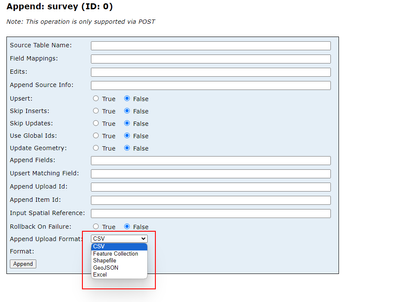

Kepa

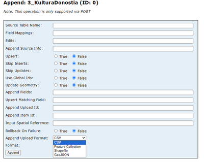

by Esri Contributor
Hi @Jelle_Stu_PR,
Be careful, you are attaching a screenshot showing another REST operation (add features). Append operation is available adding /append to the desired service's layer/table url:
For AE 10.9.1 you can use: CSV, FeautureCollection, GeoJSON (up to 100MB) and zipped Shapefile (apparently with no size limitation):
EDIT: for updates below 250 features you can use edit_features method from Python API

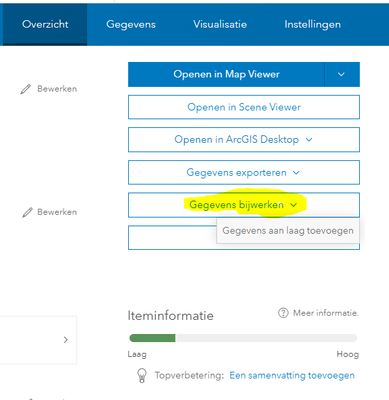

Jelle_Stu_PR
Thank you for making me aware that the append tool uses another URL. The append tool does not seem to work even in the portal UI. It looks like some underlying authentication issues. I will continue this issue ESRI support. Should a solution be found, I will post it back here.
