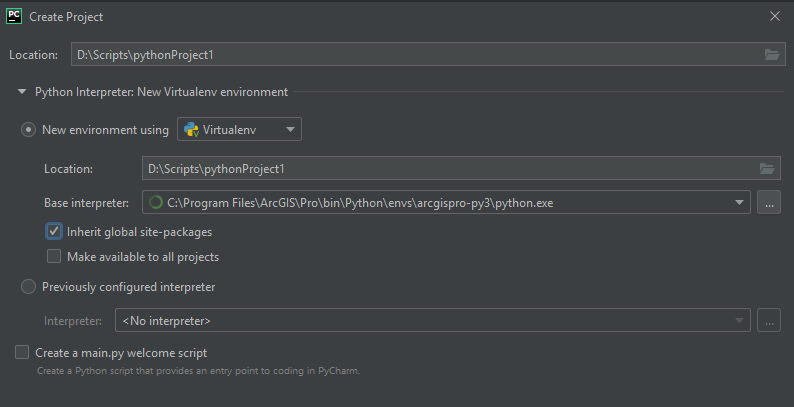

Here is my project interpreter setting (I have tried various other settings):
I did try making it a conda environment a couple times and pointing to a file within ArcGIS Pro that had conda in the name.  Note that I do not know what conda is or how it may be relevant or not in this situation.

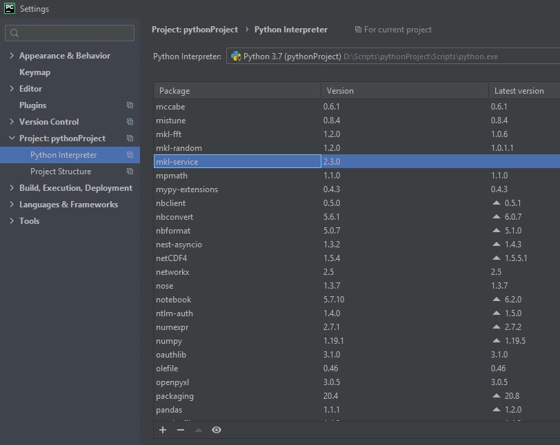

The error has something to do with numpy, and with mkl-service, but I have both of those:

Well, I finally fixed it.  I think it came down to correcting my Pro license.  I feel kind of dumb for not doing that to begin with, but it is also frustrating that there was no hint anywhere along the line that it was an issue.
I installed ArcMap on the server to see if the ArcMap version of arcpy would work any better than the Pro version.  When I did the installation, ArcMap forced me to look at the license manager and deal with it, and I realized that I didn't recall doing anything with that when I installed Pro, even though I did log into Pro with my AGOL account just fine.  I went into the licensing settings in Pro, saw that they were incorrect, and I corrected them.
Then I went back to PyCharm.  I went to edit the settings for the project interpreter.  This time, it had "system environment" as an option, along with conda or virtual environment.  This seemed like a good sign, because I had seen instructions to use "system environment" in online resources, but it was never available as an option to me.  So I picked "system environment" and the same Python path I had tried before,
C:\Program Files\ArcGIS\Pro\bin\Python\envs\arcgispro-py3\python.exe
I chose to "inherit global site packages," as I already had done in my previous attempts.  And, this time it worked!  My script successfully imported arcpy and ran!
