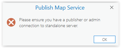

Interestingly, though, I have an old ArcGIS Pro project in which I have a server connection that has the Publish option. However, when I right click and select Publish, I get the following:

When ArcGIS Server is federated with the Enterprise Portal, it's no longer considered a "stand-alone" system and attempting to publish using the workflow above will fail. To publish a map service to a federated Enterprise system you need to make sure you are signed into your Enterprise Portal within ArcGIS Pro (check the upper-right corner) then use one of the following methods:
  • Right-click on the layer in your map table of contents, go down to the Sharing section of the menu, and choose the option "Share as a web layer"
  • From the top ribbon, go to the Share tab, and select "Share web map"
