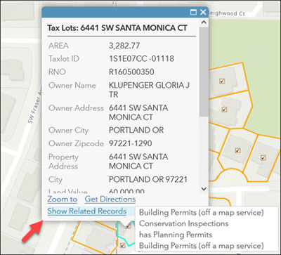

Hi Tanu, I can see the relationships to the layer in the service when I load the service in ArcMap (just for testing).  The main difference is that when I click on the features in the relationship, all I get is the attribution from the feature.  I do not see the feature flash on the map.  I'm trying to predict what sort of functionality will be available when the service/layer is accessed from an API.  I haven't found a any good example applications that have tools built into them that allows the user to query, identify, etc. on features that are part of a relationship class.  My hope is to be able to query for a feature and highlight (i.e. select) the features that are "related" to it in the rel class.

  1. Flashing related features on the map appears to be only supported in desktop apps such as ArcGIS Pro or ArcMap. It is not supported in web apps, such as ArcGIS Online Map Viewer.
    • even though the ArcGIS Online Classic Map Viewer allows you to navigate to related features easily (just doesn't support flashing from there).
      • that is supported for both map service layer (aka map image layer) and
      • feature layer (regardless of its source, which could be a map service or a feature service)
  2. You are right, the flashing doesn't work when you the service as a map service layer in ArcMap or you might not even see related records in Pro popup window
    • works fine for feature services.
