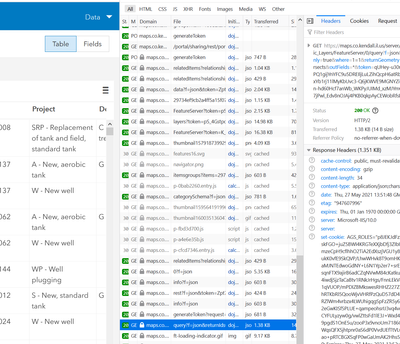

That can happen when Portal is having trouble communicating with your Hosting Server. Can you browse to your REST directory?
When this sort of thing happens to us, a quick reboot of wherever Server is running usually fixes it.

Thank you for your reply. I had a feeling it had something to do with the server because when I opened up Dev Tools, the error I was receiving on the back end was HTTP related, saying it couldn't find the link. I'm not totally sure how to access the REST directory, but I'm sure I have it written down somewhere 🤔

Oh, interesting. So Server is running fine. Do you have a multi-machine setup, or is it all on one? Either way, a reboot is a good first attempt in addressing this. You might want to try rebooting the Portal instance.
If it's still giving you trouble, you can also open your Developer Tools in your browser (Ctrl+Shift+I in Firefox) and watch the network tab when you open the Data view in your Portal. That can show you what request is attempting to be sent to the service endpoint, and what error may be getting returned. It's not always helpful, but it might give you some clues.
On one of my own layers, it's really just submitting a query and constructing the table from the results. So look for a URL like that and see if there's an error message attached.

Thank you. I just submitted a ticket to IT so that they can reset the server hopefully rather quickly so I can at least check that off. I also used Dev Tools earlier and watched the errors for opening the data tab of the HFL, opening accompanying web maps & apps and submitted those to someone at ESRI to take a look at.
This is what I was receiving, so I'm trying to interpret this. But it looks like something to do with the communication between server & portal to me. But I could be wrong.

UPDATE: IT reset the Portal Machine and everything is working again! 😄
Thank you all for your help.
