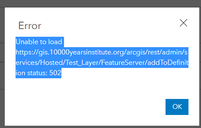

Whenever I attempt to create a new feature Layer through ArcGIS Portal, or a new Workforce project through the Workforce website, I am unable to. Errors in Portal and the Devconsole of the browser references 502 errors in some form.
When creating a Feature Layer through Portal I receive "Unable to load https://webdomain/arcgis/rest/admin/services/Hosted/Test_Layer/FeatureServer/addToDefinition  status: 502":
