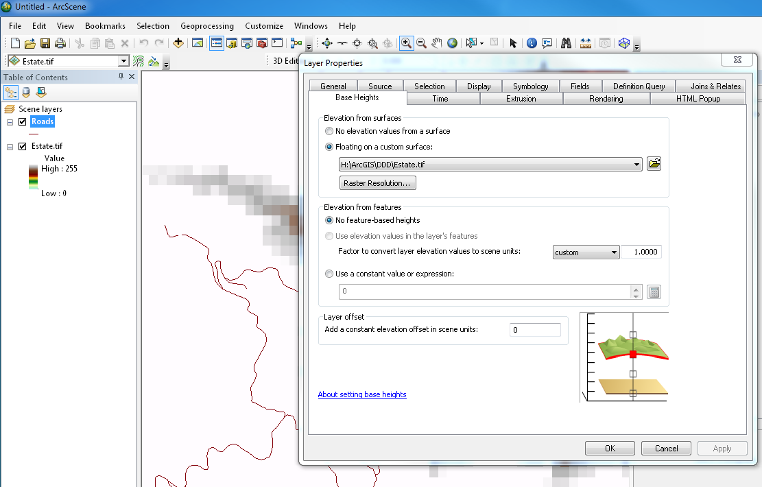

I have a Polyline feature class that is Z aware  when first built but to adjust and add new features to it. It seems I can only create another Feature class with the updated Z aware Polyline features. and generally having to delete and replace data in the database to maintain the static dataset.
I have tried ArcScene to edit in 3d with very limited success, ie it takes about 10 minutes to digitize a line of 15 vertices 250 metres long (display performance is slow). And then often it will not populate the Z attribute of the vertices along the line, I have only been successful once. (I have tried different  Elevation Sources from Raster to TIN and a few others TIF etc).
If I restart the same session and reload the ArcScene document the next day and add a new feature it again takes 10 minutes and has lost the z awareness,
The Polyline Layer knows the Elevations are derived from the 3D Surface but it will not populate the Z value.
