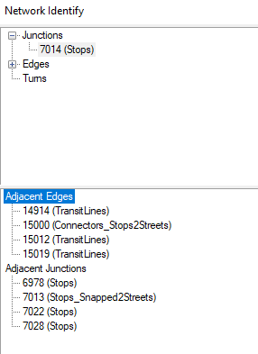

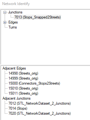

I believe that the network identifier tool shows that my streets, transit stops snapped to streets, connector lines, transit stops, and transit lines are all connected correctly. The first image here is network identify when I've selected a transit stop. The second is when I select one of the snapped-to-streets transit stops. Both show (Am I correct?) that they are connected to the adjacent networks: roads, transit lines, and the lines connecting the stops to the snapped-to-streets stops.

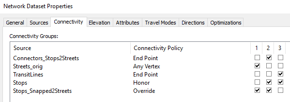

Here are my connectivity settings. I also tried changing "stops_snapped2streets" to "honor" and rebuilding the network, but it didn't solve the problem.
