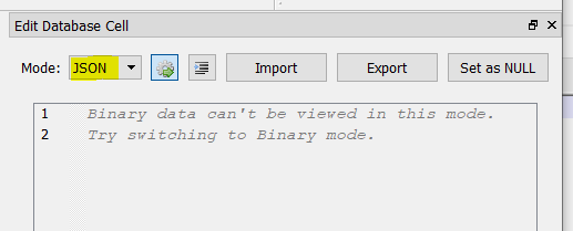

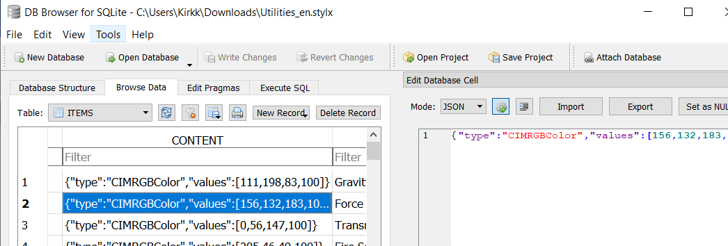

When I open Utilities_en.stylex with DB Browser for SQLite 3.11.2, I can see the Content column in the Items table as json.

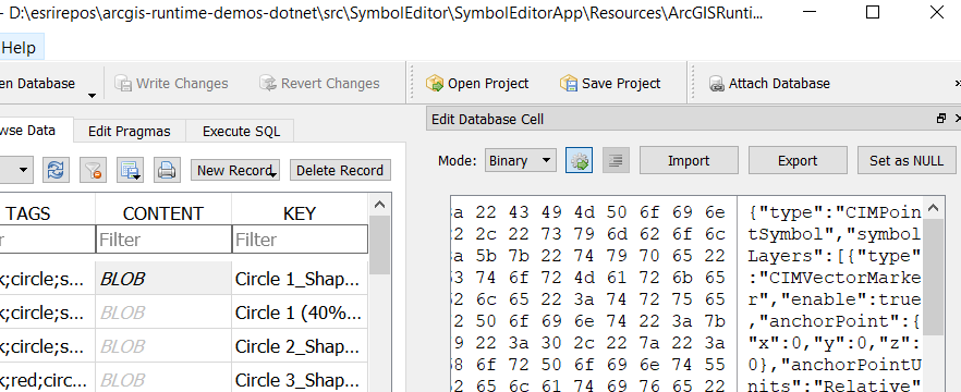

However, when I open the ArcGISRuntime2D_Pro25.stylx  from the symbol editor sample, it treats the Content column as a Blob.
Can't change the mode either...

For those that come across this, ‘…For some reason, the json string has a character at the end that makes DB Browser think it's a blob instead of text. If you delete the 00 at the end, it will then display as text and you can get an idea of what the json looks like for a CIMPointSymbol for example...’
from https://community.esri.com/t5/arcgis-pro-documents/how-to-programatically-add-symbols-to-a-stylx/ta-...
that article is good for messing around with stylx files, and I don’t know any other way
