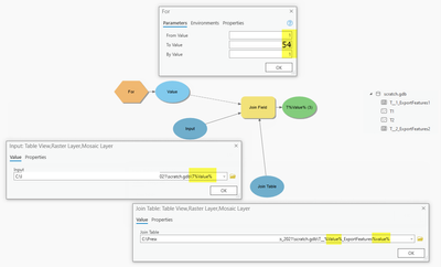

ShitijMehta
try this. pls let me know if this works
ThomasGillespie
Thanks ShitijMehta,
Could you post a higher resolution image please?
ShitijMehta
try now.. U might be able to make the image larger by hovering over the image and clicking once... pls can u check? ty
