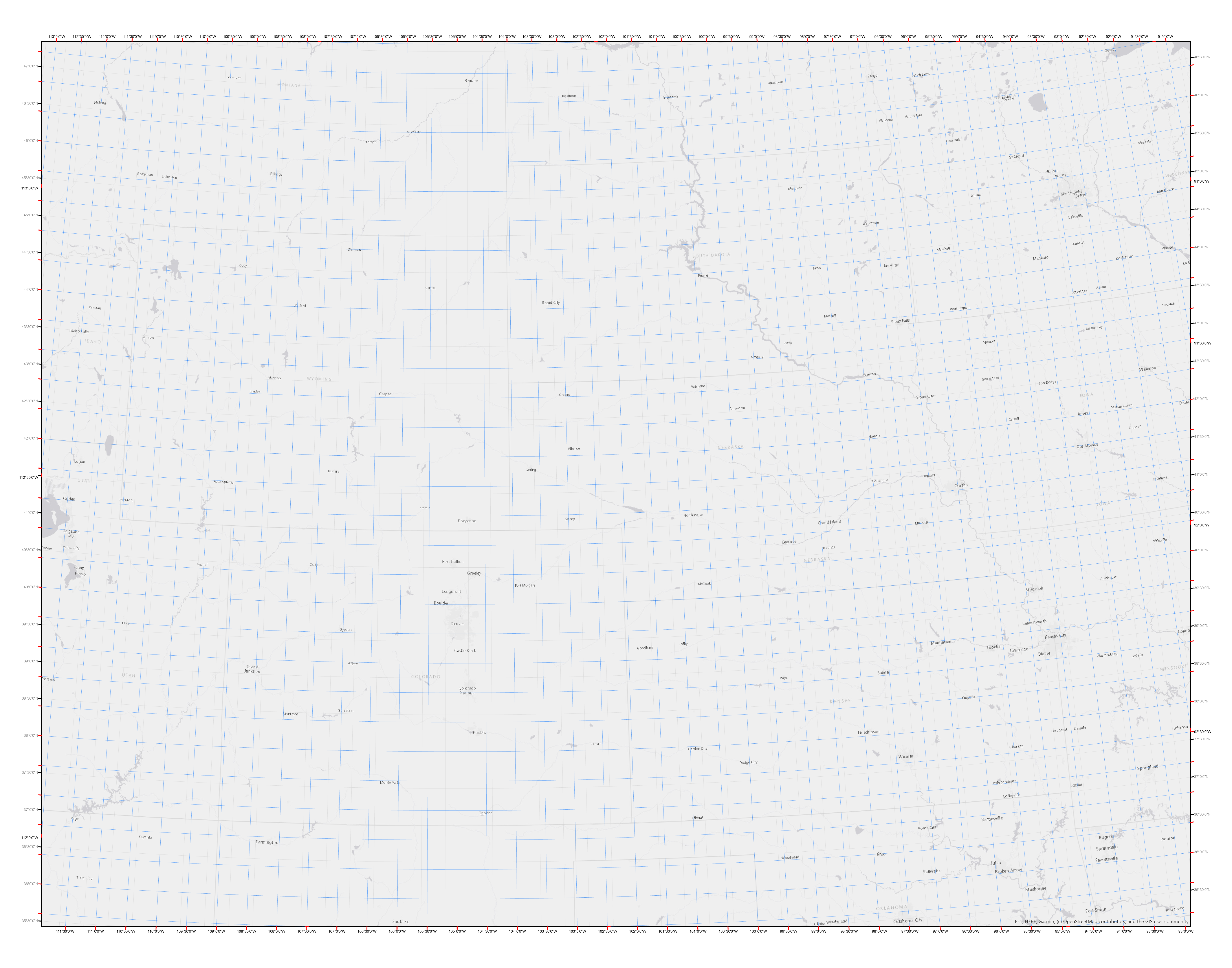

So I have been working on setting it up the Grids in ArcMap 10.5.1 in the Layout and then I create two
grids apart for one is  Latitude and the second one  for Longitude ...
See picture and this is from ArcGIS Pro 2.4.1
Here is the example
Now I imported it from my MXD file into ArcGIS Pro and now it is currently in Map Frame...
Is there a way around for me to export them into lines ?  I do know that I can convert it to Graphics but it doesn't dynamic  so... I want to get some feedback from you .
So my question has anyone succeed    convert it to Layer as a line ?  I'd like to hear from you and I need that to work on my georeference ....  anyone ??

Hi Robert,
Currently there is no way for you to create map features (layers) from a map grid. This is something we hope to get to sometime in the future.
Is there a particular reason you need these to be features in the map instead of an element on the map frame? What is the end product that you have in mind?

In most cases tick marks and labels for grid/graticules are drawn outside of the geographic bounds of the map (map frame). This is a major reason they are properties of a map frame and not features within the map.
The 2 main uses cases that I'm aware of that would require the grid/graticule to be features within the map are:
1. You are publishing the map to a web service (and the map viewer does not support grids/graticules like Pro does)
2. You want to draw some features above the grid/graticule
If you are not doing any of these you might find that Map Frame grids can support the result you want. For more information on grids and graticules please see Grids and graticules—Layouts | ArcGIS Desktop.
