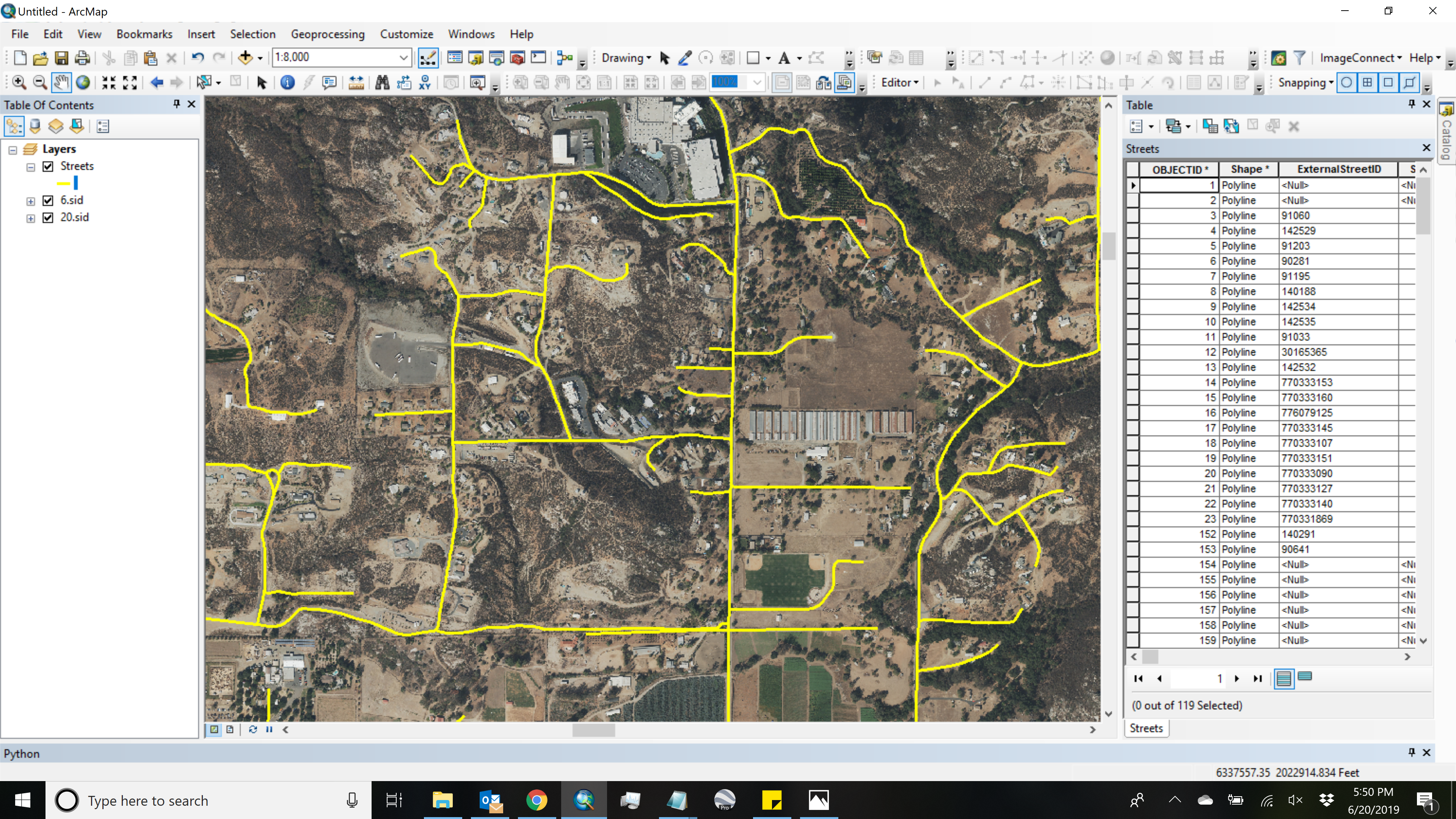

Behavior

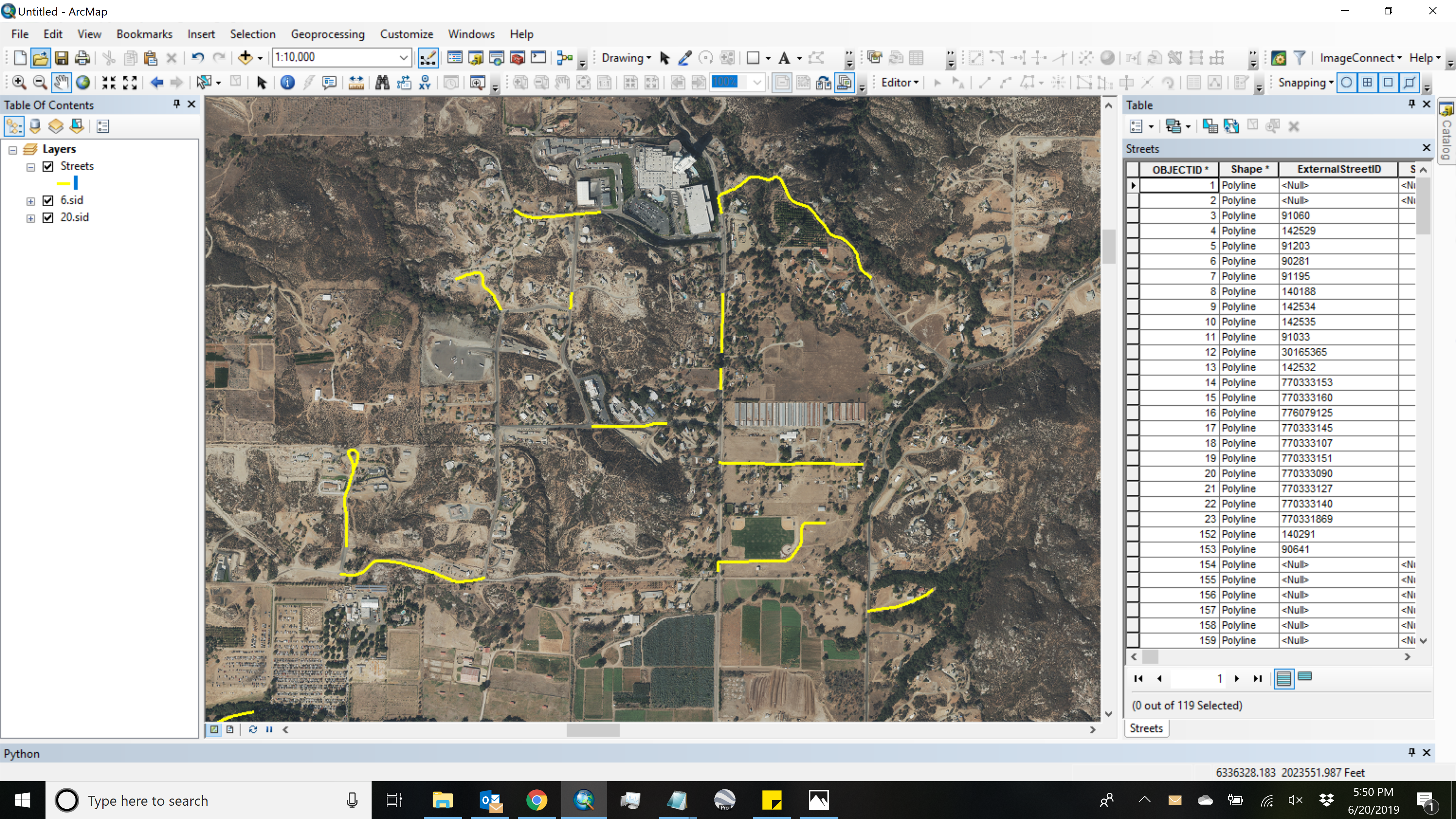

Only a small fraction of the features display at full extent. If you zoom in on many of the features, everything displays like normal. When you pan or zoom so that certain features are in the map extent, however, most of the features vanish again. It's like certain features were somehow tainted.
Full Extent:
Just one zoom level further:

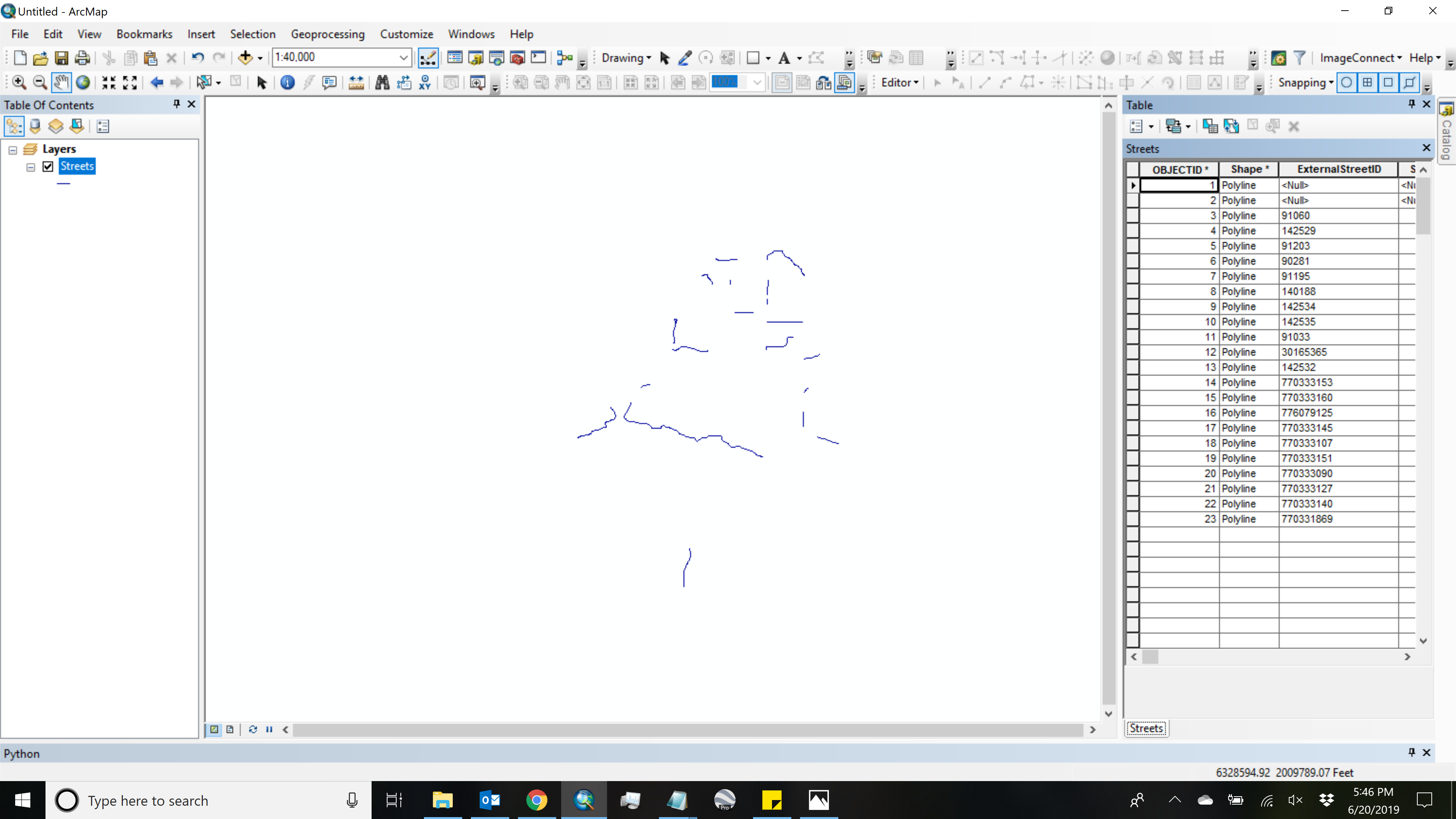

Opening the attribute table initially shows the first 23 features and many blank rows. After a second or two, the blank rows populate so that there are 119 features in the table. There should, however, be upwards of 236 features in that FC! but quickly catches up and displays 119 features (There should be upwards of 236 features). The weird thing is that everything seems to display at certain extents, but not other extents!
First 1-2 seconds after opening the attribute table:
After most, but not all features populate. Note the significant gap in ObjectIDs:

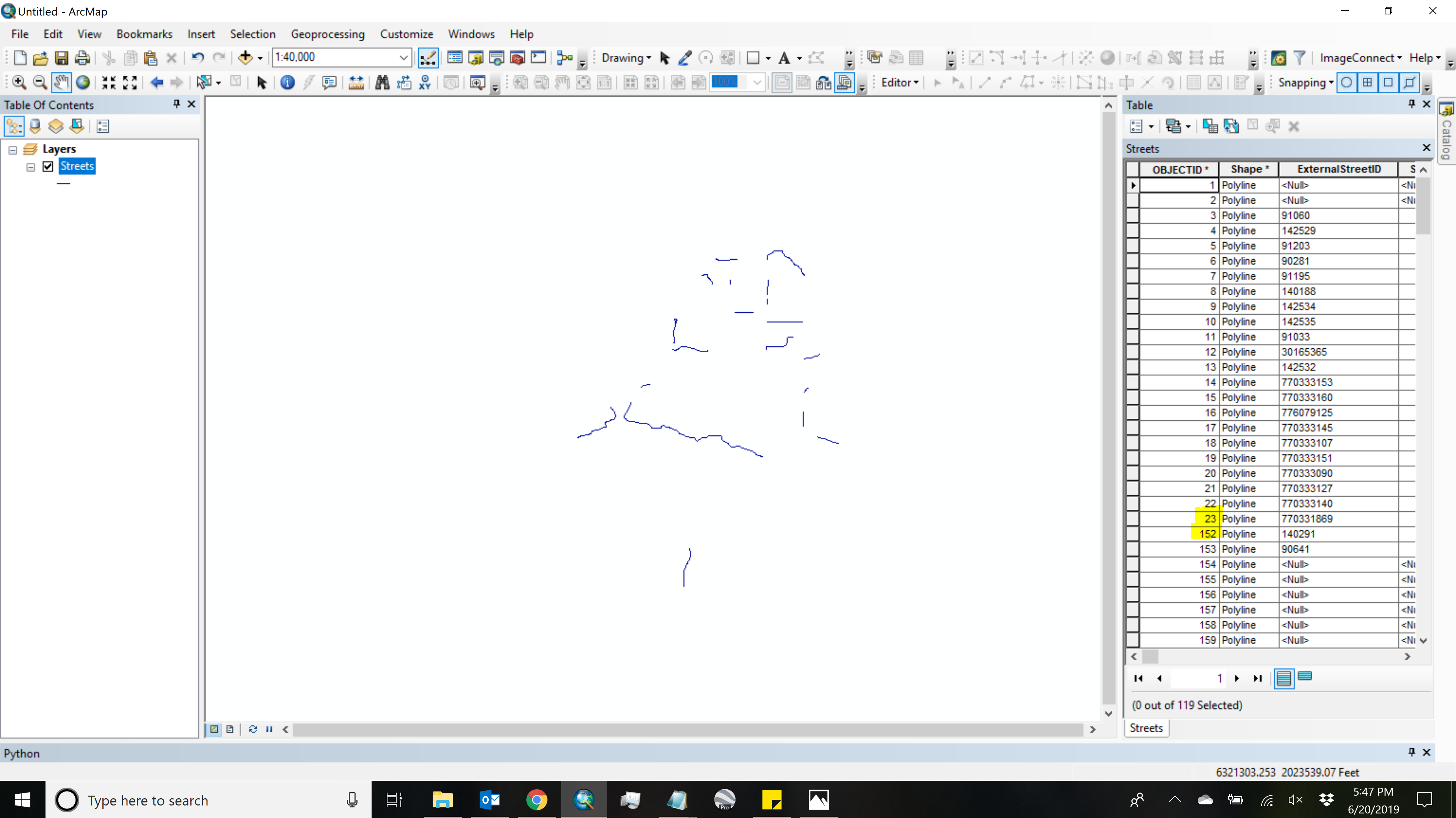

Thanks for the tip! The PROBLEM code returned by Check Geometry was
"Short Segment - Some segments are shorter than allowed by the system units of the spatial reference associated with the geometry."
This is strange because the FID indicated is 23, highlighted in the second image below, and obviously not too short for the map units (US_Feet; I'm using California State Plane VI).
Check Geometry Output with problem feature in view:
Streets attribute table with problem features in view:
I ran the Repair Geometry Tool with "Delete Features with Null Geometry" unchecked - Check Geometry found no features with Null Geometry. Received:
WARNING 000461: Repaired feature 23 because of short segments
WARNING 000986: C:\...\Streets0.txt contains the full list of non simple features.
Streets0.txt only says Repaired feature 23 because of short segments. Nothing has changed about the FCs behavior. I ran Check Geometry tool again, but it found no errors.
