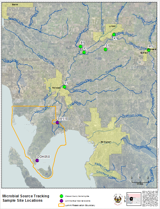

I have recently started having troubles exporting to PDF where certain colored circle marker symbols appear as black dots.
I have read the information posted here: 17783 - Diagnose an ArcMap printing or exporting problem  but get the following results when publishing as EMF.
If I export to EMF and view the resulting file in MS Paint the symbols appear as they do in ArcMap.
If I export to PDF from ArcMap 10.3 I get some colored dots appearing as black dots and others appearing as they should.

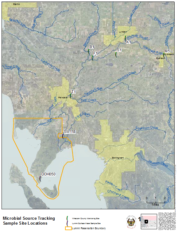

If I add the EMF file to an MS Word document all the dots appear as crescents.

Above is the original from ArcMAp
Above is the EMF as it appears in Word.

I'm not sure about the black dots, but the ones appearing as "crescent" (aka parenthesis) are most likely a font issue. Many of the marker symbols are made from fonts. If the fonts aren't accessible for some reason then it defaults back to the first font in the fonts on the machine. Usually that is Arial.
Are these exports being opened on the machine they were created on? Or are they being opened on machines that don't have the esri fonts?
When you export you might try the Embed fonts option (for pdf) or the Convert markers to polygons (for pdf and emf).
