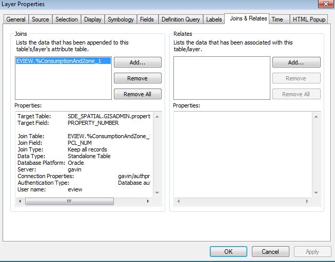

I think create a join to my SQL Query Layer:
I then run Feature Class to Feature Class tool, and this is the name of the output fields:
