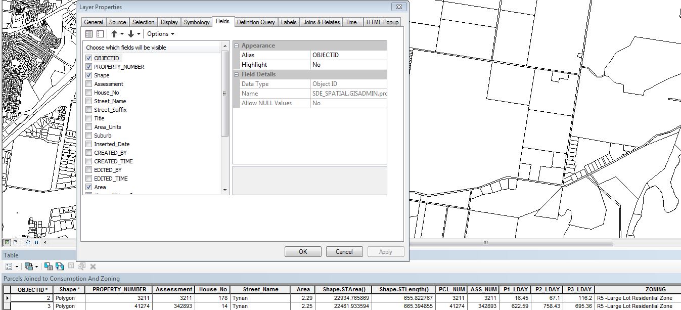

Here is the original Feature Class properties:

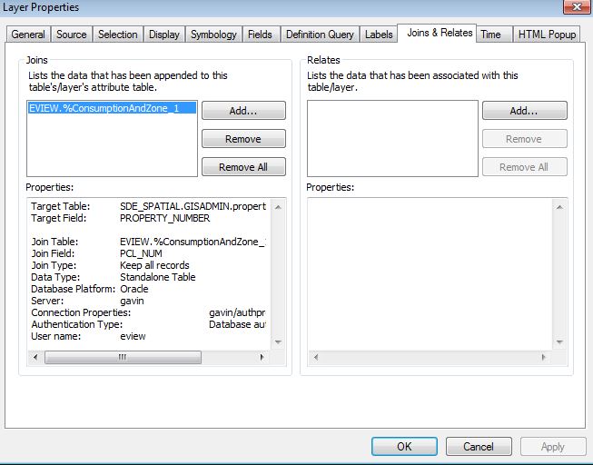

I think create a join to my SQL Query Layer:

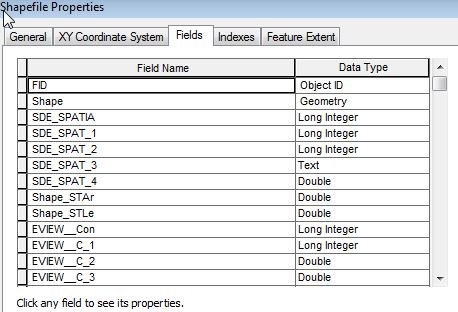

I then run Feature Class to Feature Class tool, and this is the name of the output fields:
