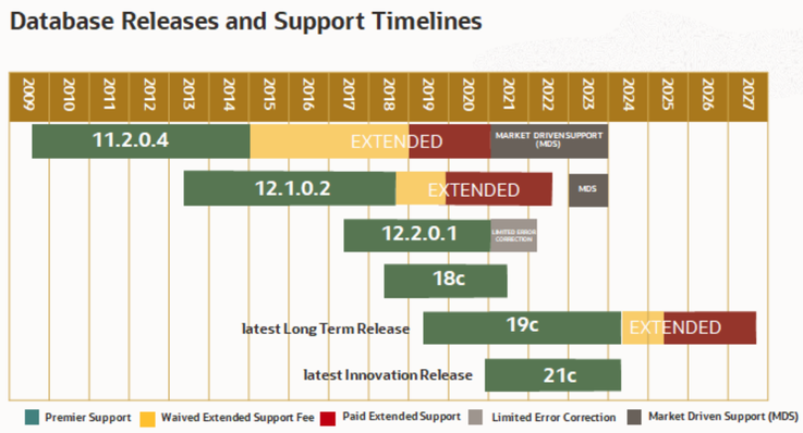

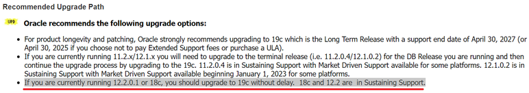

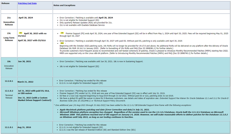

B. Oracle 12c has reached end of life by Oracle and customer needs to migrate to 19c + latest patchset
  21c is the innovation release, skip that version
  19c is still the long term release
ArcGIS 11.0 and ArcGIS Pro 3.0 requirements for Oracle—ArcGIS Enterprise | Documentation for ArcGIS ...
My Oracle Support - Release Schedule of Current Database Releases (Doc ID 742060.1)
- Oracle Database 12.1.0.2 is now in Sustaining Support
- Oracle Database 12.2.0.1 is now in Sustaining Support
