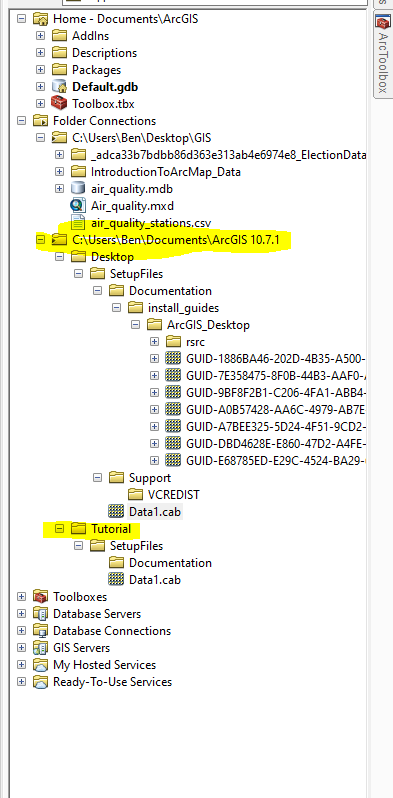

I have been able to (pictures of these steps below):
  1. download the folder through the online link
  2. Attach folder connection into the catalog
  3. None of the sub-folders that I am seeing in the examples are showing up in the catalog view OR when using the add data toolbar
  4. Attempt to drag over data.cab (not sure what this is...)
  5. receive an error message
The tutorial folder in the catalog toolbar
Error when I drag the Data1.cab info over
Error after hitting OK:
That's it for now. Tune in next time as I figure out what .mxd and .cab files are! If we are lucky and have time I may even look into those error messages

It looks like we are talking about different arcgis folders. You want to find the arcgis folder at the root of C, not in the documents folder. You can paste "C:\arcgis" into the navigation bar to get there.

This file is actually an executable (ArcGIS_Desktop_Tutorial_Data_1041_151862.exe). So if you have not already, you'll need to double-click to install that before you have access to the data. I also ran the Setup.exe in Documents\ArcGIS 10.4.1\Tutorial. I'm not sure if that is necessary.
Once you've installed the data, you can find what you need for your lesson in C:\arcgis\ArcTutor\Editing

Please double-click and run the Setup.exe shown in your last screenshot. You should then have data in C:\arcgis\ArcTutor\Editing

Thanks for clarifying. Can you confirm that there is nothing at C:\arcgis\ArcTutor ? I tried again and saw the same message about 0KB, but I still see all the data appearing at this location after running Setup.exe
BenHoward
I am not even seeing ArcTutor in my C:\arcgis folder.
Documents folder:
ArcGIS Folder:
HeatherSmith
Esri Alum
Hi Ben,
Thanks for sending those images, that makes it clearer.
