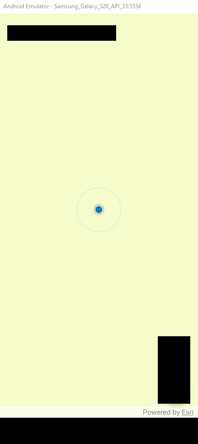

Hi, we load an mmpk file from the local storage since we can not longer export maps from ArcGIS enterprise on kubernetes due to this issue.
We now experience a strange behavior after loading the map. The map displays a lime colored rectancle. When zooming, the area outside this rectangle is rendered correctly. But when I stop zooming, the entire map shows the lime rectangle again.
Might this be a mistake we make while exporting the MMPK from ArcGIS Pro?
Here is a gif showing our problem.
padmalcom
We found the error we made. While exporting the mmpk we defined a polygon which was included in the mmpk as layer above the map.
