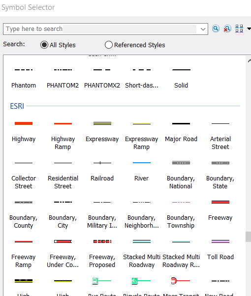

I am using ArcMap 10.3.

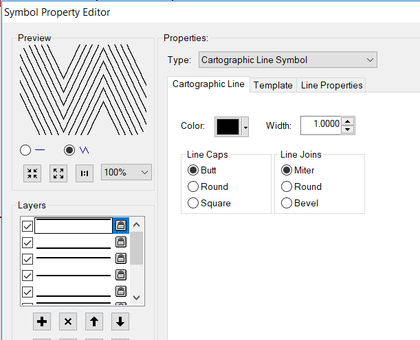

Is there a way to make a straight polyline zigzag?  There are some line options in the Symbol Selector but nothing that is zigzag.  These are a few of the options.
This is how I want my lines to be represented...is it even possible?

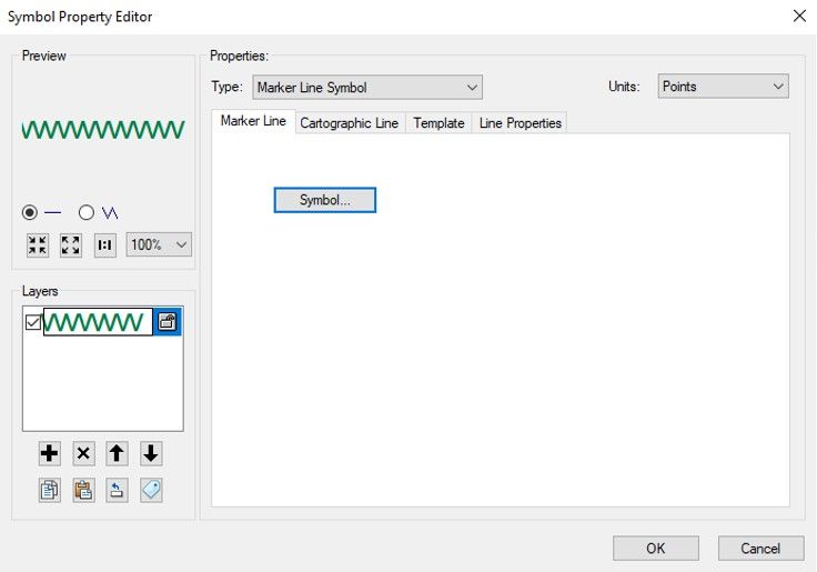

KyleTobias1
My solution was to choose a Marker Line Symbol of the letter V.  When the V repeats, it turns into a zigzag!ZigZag.jpg
