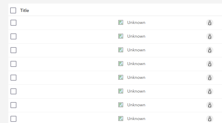

We were able to successfully run the WEBGISDR Restore process from an ArcGIS Enterprise HA 11.2 environment to a Single Machine 11.2 environment. However, even though the WEBGIDR --import process was successful and we can validate our Data Store and Hosting Server, we not seeing any REST services and all of our content is blank in Portal. Users and Groups came over fine. Any thoughts?
This is an AWS-hosted ArcGIS Enterprise 11.2 environment. Been following this blog as a guide along with the documentation.

Seems more like a Portal for ArcGIS issue to me than datastores. What is not displayed correctly is the result of the following URL: /sharing/rest/search. Did you maybe try to reindex (portaladmin/system/indexer/Reindex ?). How does your Portal for ArcGIS content folder look like ? Was it successfully restored (ie: can browse your items and find the thumbnails and so on) ?
Disclamer: just trying to help by throwing ideas, not working for ESRI !
MikeSchonlau
Yes - the problem definitely seems to be with Portal and the REST services. It looiks like reindexing is not an option at this version based on this article. I am now more curious about the portal content directory as the old one was hosted in AWS S3 and the new one is hosted on the ArcGIS Enterprise machine. I'll take a closer look. Thanks for the advice.

Hi @MikeSchonlau, can you have a look under "your_install_dir"\arcgisserver\config-store\services\hosted, is the hosted services reflecting here? if not then your webgisdr might not have backed up the hosted services, you can try export site under https://dns:6443/arcgis/admin it only exports ArcGIS Server, and import it to the new site.
Hope it helps
Henry
MikeSchonlau
Henry
Thanks for your feedback. You are definitely on to something here. In our existing environment, our config-store uses cloud storage (AWS DynamoDb). In our restore environment, we want to use FileSystem. I checked the config-store folder on our Restore instance and none of our services are there. That is probably the root of our problem. Thanks for suggesting that. The moral of our story is that if you deploy AGE using cloudbuilder for AWS, restoring gets more complicated.
