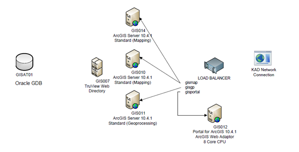

Below is a diagram of how our ESRI infrastructure is configured. GIS011 is configured to run geoprocessing services. This is where my geoprocessing service is hosted but the print tool will call map services hosted on all servers (GIS014, GIS010, GIS011). The Web Map App is hosted on GIS012.

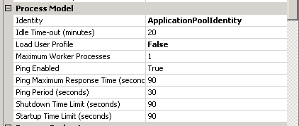

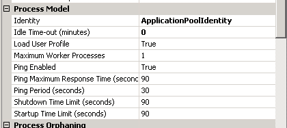

I also looked into this thread. Find below my configs on GIS012:
Advanced settings on ArcGISWebAdaptorAppPool:
All others:
