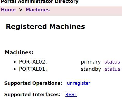

Jumping into this thread. We discovered a major issue with our HA Portal environment. If we turn the primary machine off the portal switches over to the other machine as expected and makes it primary. Problem is, that the load balancer still tries to direct traffic to the now off machine causing portal to hang as it knows no way to send traffic to the primary machine.
Has anybody else encountered this issue? How do we configure the load balancer to only direct traffic to the primary if the standby is actually switched off?
With all the tests we have been doing (switching machines off and on) we seem to be in error state where portal does not know which machine is the primary. We can no longer log in to portal/home or portaladmin. Checking the logs shows an error: HA: Master down, check if this node needs to be elevated to be the new master.
Given that we cannot log in how can we change the Master to the machine that is currently switched on? We are using 10.6.1.
