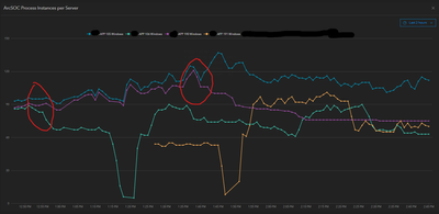

I have an ArcGIS Enterprise 10.9.1 infrastructure with four nodes configured to be highly available on Windows Server 2016. For the past three weeks, the nodes have been experiencing spontaneous crashes where the number of ArcSOC processes drops to about half or even zero (as observed in ArcGIS Monitor). When this happens, the services become intermittent, and some incoming requests to the affected server fail.

Image 1. A server failing to lose ArcSOC Instances

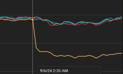

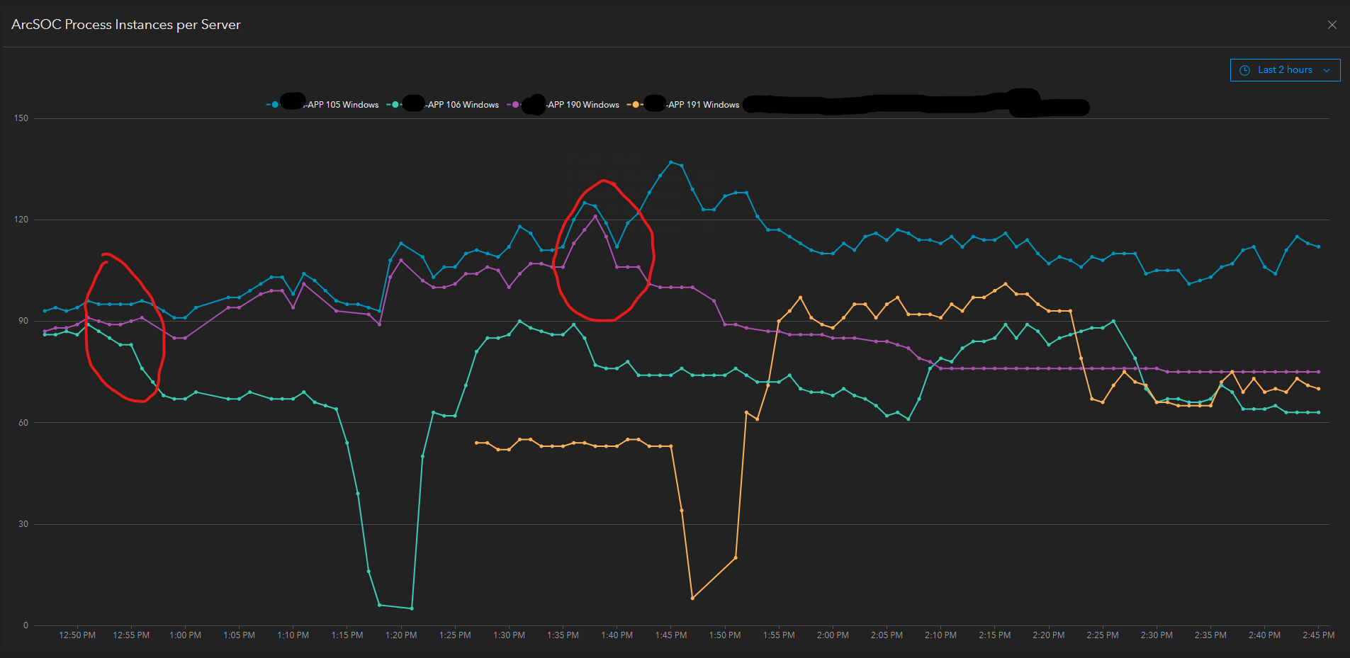

Image 2. Servers failing (red mark). Yellow one tries to synchronize but stops all ArcSOC processes and then tries to create them again but fails. This image shows how I went from 3 nodes working well to just 1 in a pair of hours.
