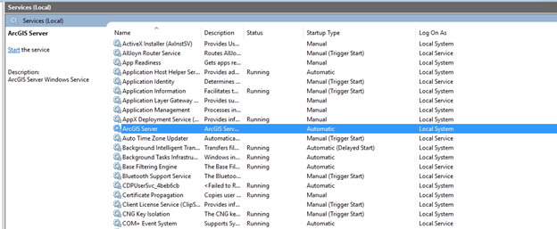

Basically when installing new version 11.5 on server01 machine, arcgis server windows service, change from log on as with domain user, to log on as Local system.

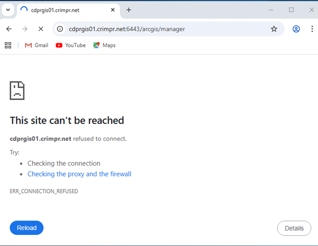

logonas.pnglogonas.png I change log on as user to the domain user that was used with all the other components but site does not start
i checked instances and arcgiserver.exe, cmd.exe, javaw.exe and rmid.exe are running but arcsoc.exe are not. What should i check of try to do in order site works? any idea.
