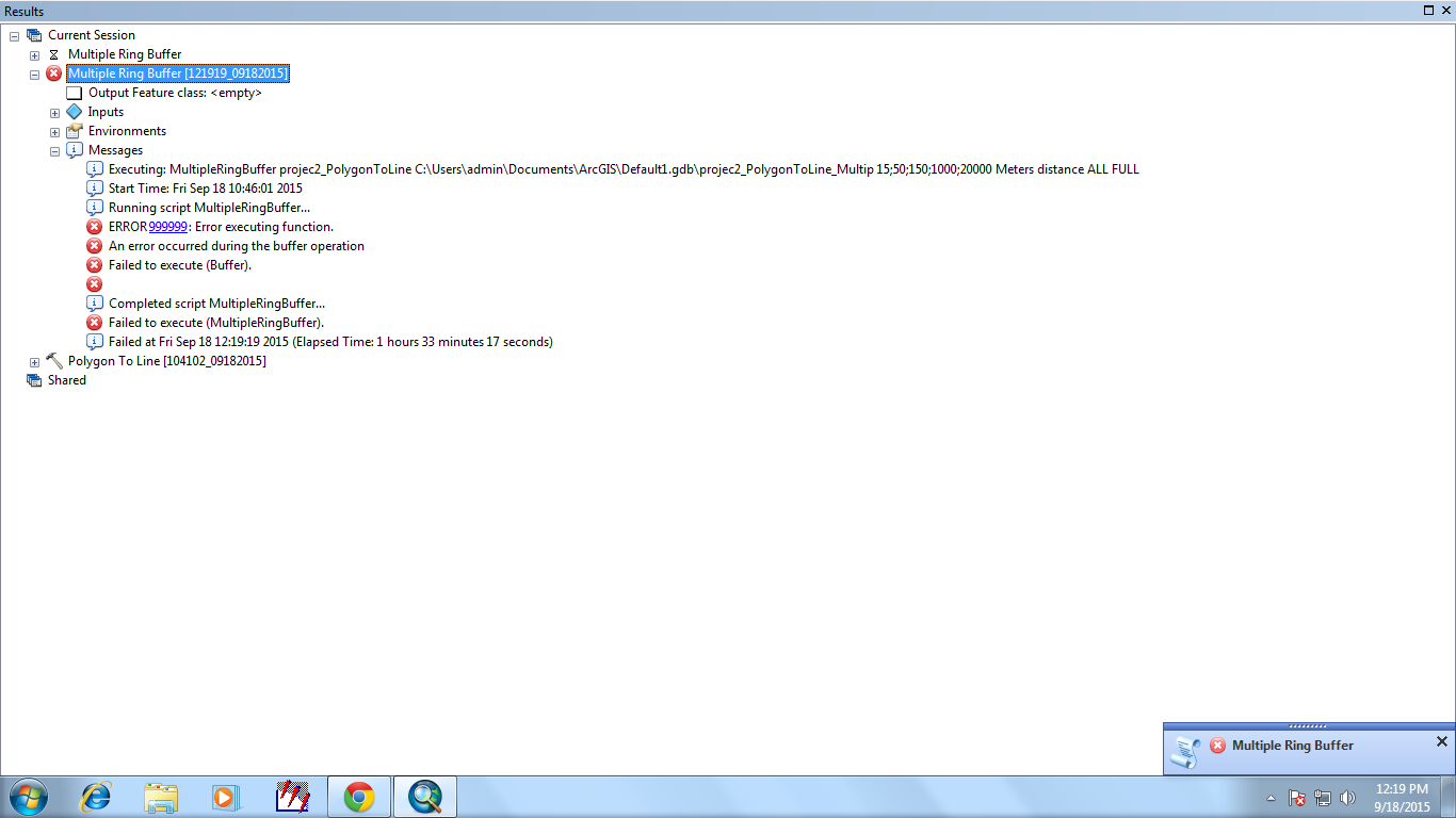

i am working on glacier boundary shape file of Himalaya region, when i applying multiring buffer on it errer is coming always, having errer ID999999?

Dear sir
     the buffer type is overlapping and no of buffer is 13
1.input feature----polygon file
2.output feature class----feature class
3. distances--15, 50 150,300,500,1000,5000,10000,15000,20000,100000,300000
4.Buffer_Unit----meter
5.Field_Name--distance
6.Dissolve_Option---all
7.Outside_Polygons_Only---uncheked
LitanMohanty
Deactivated User
the error message is like that.

LitanMohanty
Deactivated User
Dear sir
The file is much more big, so i divided it into 3 part and then reproject them properly, and then tried. i have tried many times and noticed that the more value of multiring buffer i.e. 10000, 1000, 5000etc meter formed sucessfully but not the 15, 100, 200meter buffer distance.
your 1st suggestion i couldnot get it properly so please describe properly.
thank you sir for your valluable reply
LitanMohanty
Deactivated User
1.when i apply a single layer buffer file it works for every distance but for all layers at a time it failed.
2.sometimes i gave outputfile name like ''E:\himalayalitan\New Folder (2)\New folder\111.shp''
                              ''C:\Users\admin\Documents\ArcGIS\Default1.gdb\projec2_MultipleRingBuffer2''
3.i dont know at what limit it stop working but the output always like ''failed in multiringbuffer'' for trying all layes at a time.
