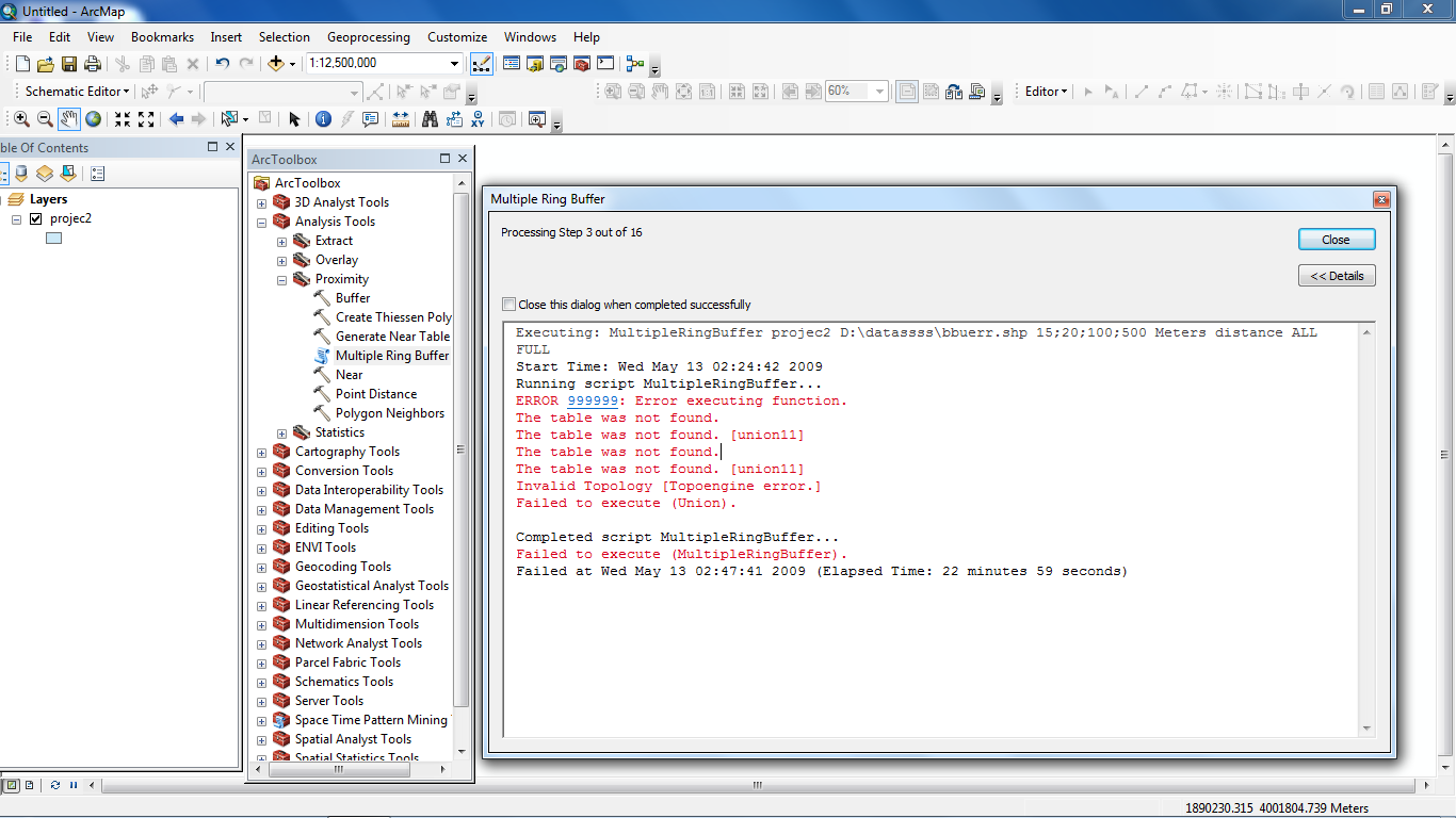

errer snapshot

when i apply repair geometry tool it failed. i am attaching that file.
the error message is like that.

This may not help, but can you try running the process in foreground. Per your screenshots currently it's running in background. Error ID 99999 is generic and doesn't tell anything. But I have seen sometimes running the tools in foreground helps. Give it a try.

Ahhhh based on your last image, it is clear... it failed because it was being run in 2009

i couldn't understand ''being run in 2009'', what is mean by 2009.
look at your results window and the run date wed may 13 ....2009
some temporal issues with your configuration?
