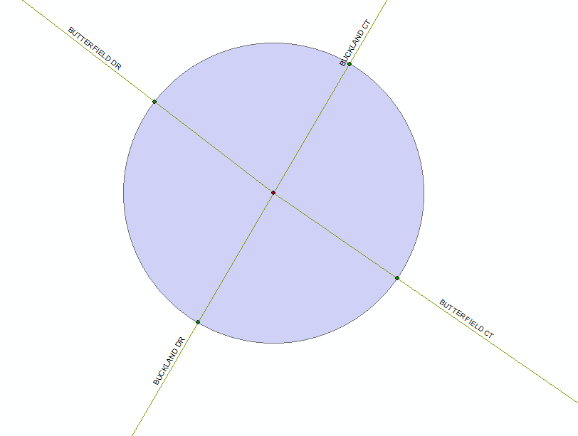

Here is my work flow: I have streets that I have already created intersections for using the method outlined here - https://community.esri.com/thread/21850. I then performed a 2 meter Buffer on every intersection. I created a unique ID field for each circle created [str(!OBJECTID!)+"xCIR"]. I then performed an Intersect between the street centerlines and the Buffer layer.
This is an example of what I've done:

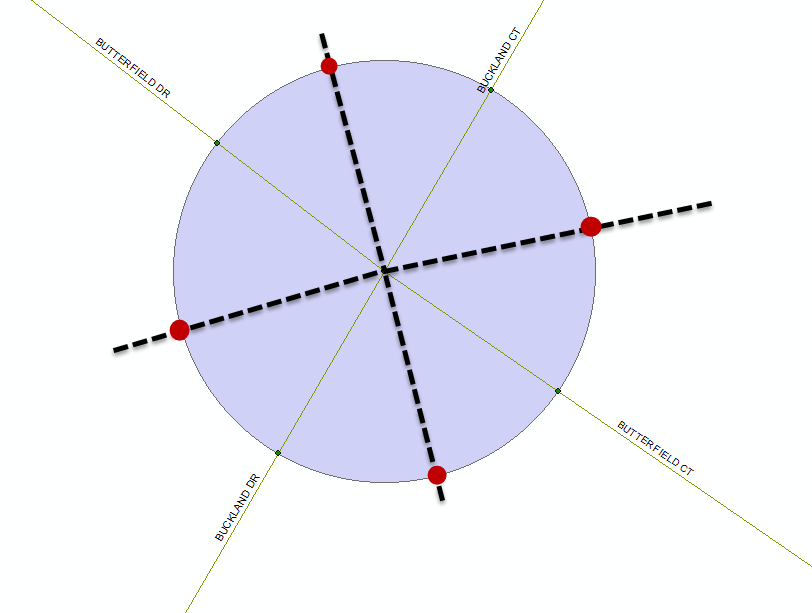

What I want to be able to do is create points that will basically an offset of the intersection points. I figure I would get the angles the points lie on the buffer's edge and simply take the average to get the angle halfway between the two points (or some method along those lines):
I would then like to be able to create two fields and populate the first street is to the left of the point and populate the second with whatever street is to the right.
