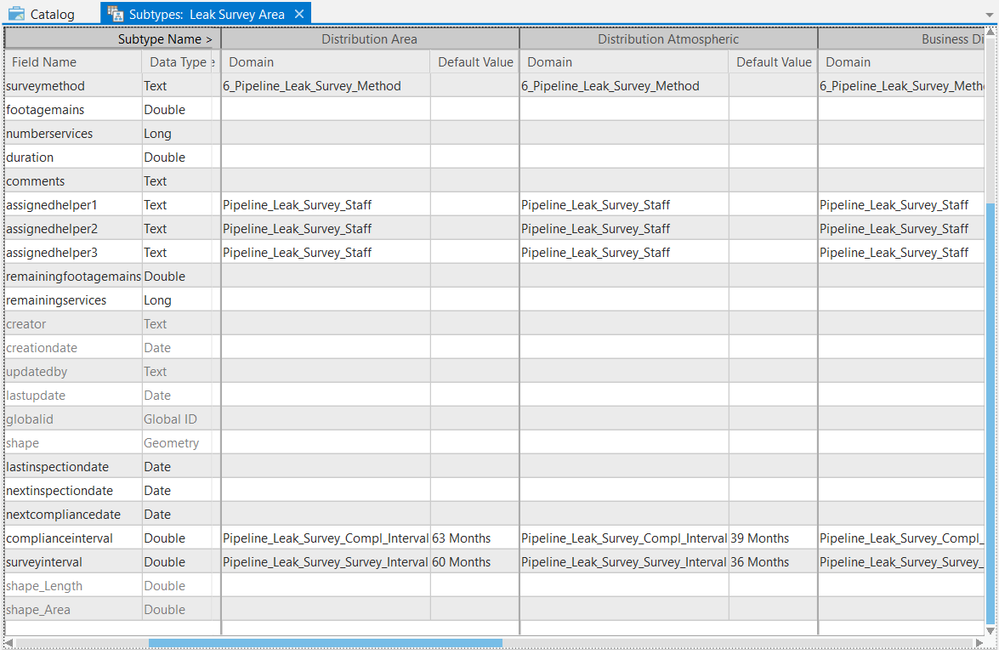

The first step is to have the leak survey record data organized and maintained in a manner that does not require programmers or IT Administrators to implement a new type of leak survey or a new inspection interval for an existing survey.
Within ArcGIS, this is accomplished by using subtypes and subtypes specific default values within the Leak Survey Area featureclass.
The Leak Survey Area featureclass is a polygon featureclass which stores all leak survey areas for a gas organization. This includes distribution business districts, distribution area surveys, distribution atmospheric surveys, cast iron surveys, as well as the different types of transmission and gathering leak surveys.
Each type of leak survey is defined as a subtype within the leak survey featureclass. This allows each type of leak survey to have unique default values and coded value domains.
This configuration of the leak survey data allows each unique type of leak survey to have its own next inspection date and next compliance date intervals.  Should these intervals ever change, a simple edit by the data owner of the leak survey data is all that is needed to implement the change.

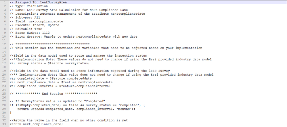

7 - Consistent Calculations
Consistently and accurately calculating the next inspection date and the next compliance date for a leak survey area when it is completed is mission critical to the leak survey program. Within ArcGIS, this can now be easily implemented with attribute rules.  Attribute rules are arcade scripts stored within the leak survey featureclass to bind a specific business rule behavior to the featureclass. In this case it is the calculation of the current completed inspection date with the inspection interval.
                COMPLETED DATE + INSPECTION INTERVAL = NEXT INSPECTION DATE
Here is what the attribute rule with some documentation looks like for calculating the next compliance date.
Because this attribute rule uses each leak survey area’s individual values for CompletedDate, NextComplianceDate, and ComplianceInterval, the script never needs to be modified when the regulations change.  Only the subtype and record data need to be modified.
