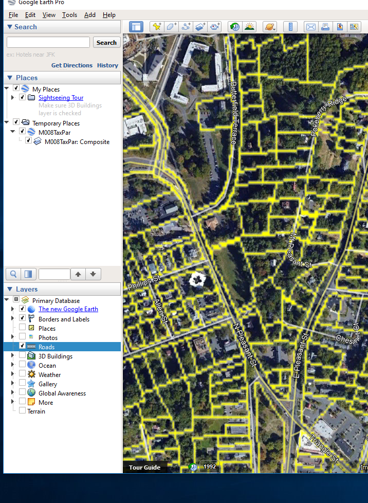

I have encountered some strange "zig zag" lines while working with an .mxd file and downloading some tax parcel property lines onto the map. I am creating a map of a small area of about 5 towns and have added a layer which is actually a polygon on top of the raster image of the area I am studying.  The taxpar "lines" don't look like lines at all ,but rather appear like a sawblade edge. They also do get really fuzzy and pixelated when I zoom in.
Please help as this is a very important project for us.

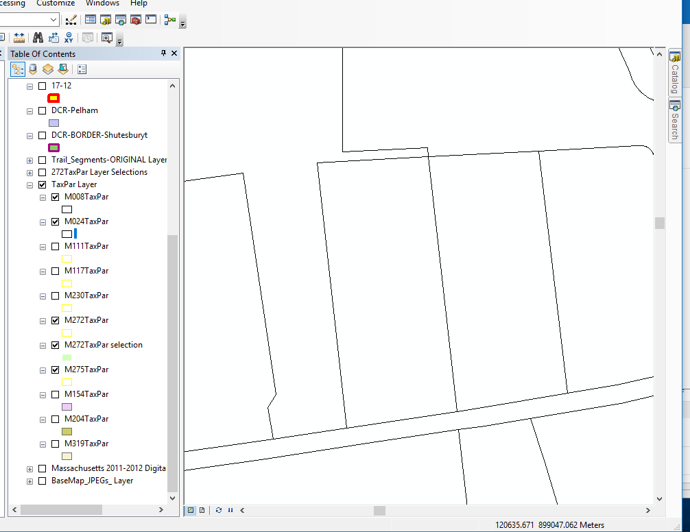

LawrenceTucker
John,
   Thanks much for your help. I have tried to change the symbol and that has not worked.
I have attached a "snip" of what I am encountering.
the lines appear to be vectors, but perhaps you are on to something by referring to them as curves.
Also, need to address the blurring or pixelating when I zoom in.
              thanks,
                LT
LorenMuehlius
I know in ArcGIS Desktop if you had a layer with transparency above other layers, it would rasterize layers below (even vector layers). Don't know if Pro does this, but may be something to look at.

CraigWilliams
Can you provide more information about how you're bringing this data into Google Earth? As a service?  Exported as KML?
CraigWilliams
Your lines are vector or are they part of the raster? It sounds like you may be looking at raster data.
