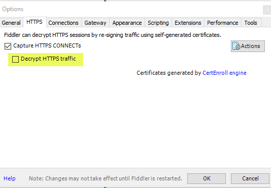

If you’re already familiar with Fiddler, open the Options dialog, click the HTTPS tab, and uncheck the ‘Decrypt HTTPS Traffic’ option.
default fiddler settings

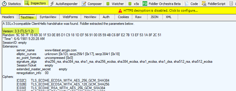

  • Check Fiddler. Select a session in fiddler:

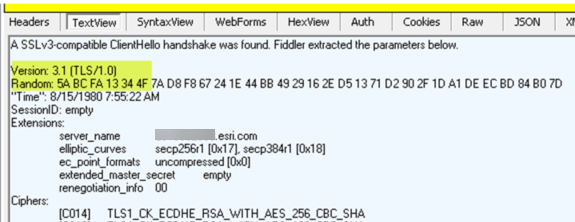

  • On the right side, under the ‘Inspectors’ tab, click the ‘Textview’ subtab. Check for the TLS version:
  • Note that I can see that I’m using TLS 1.2 in my outbound communication – which makes sense, my instance of ArcGIS Desktop is patched!!
  • But what if it’s unpatched, or I don’t know, or I’m curious, or I’ve modified this workflow slightly to test some app OTHER than ArcGIS Desktop? What will that look like? In that case, Fiddler won’t tell us that the app is using TLS 1.2. Instead, it’ll state something else in this case, TLS 1.0.
