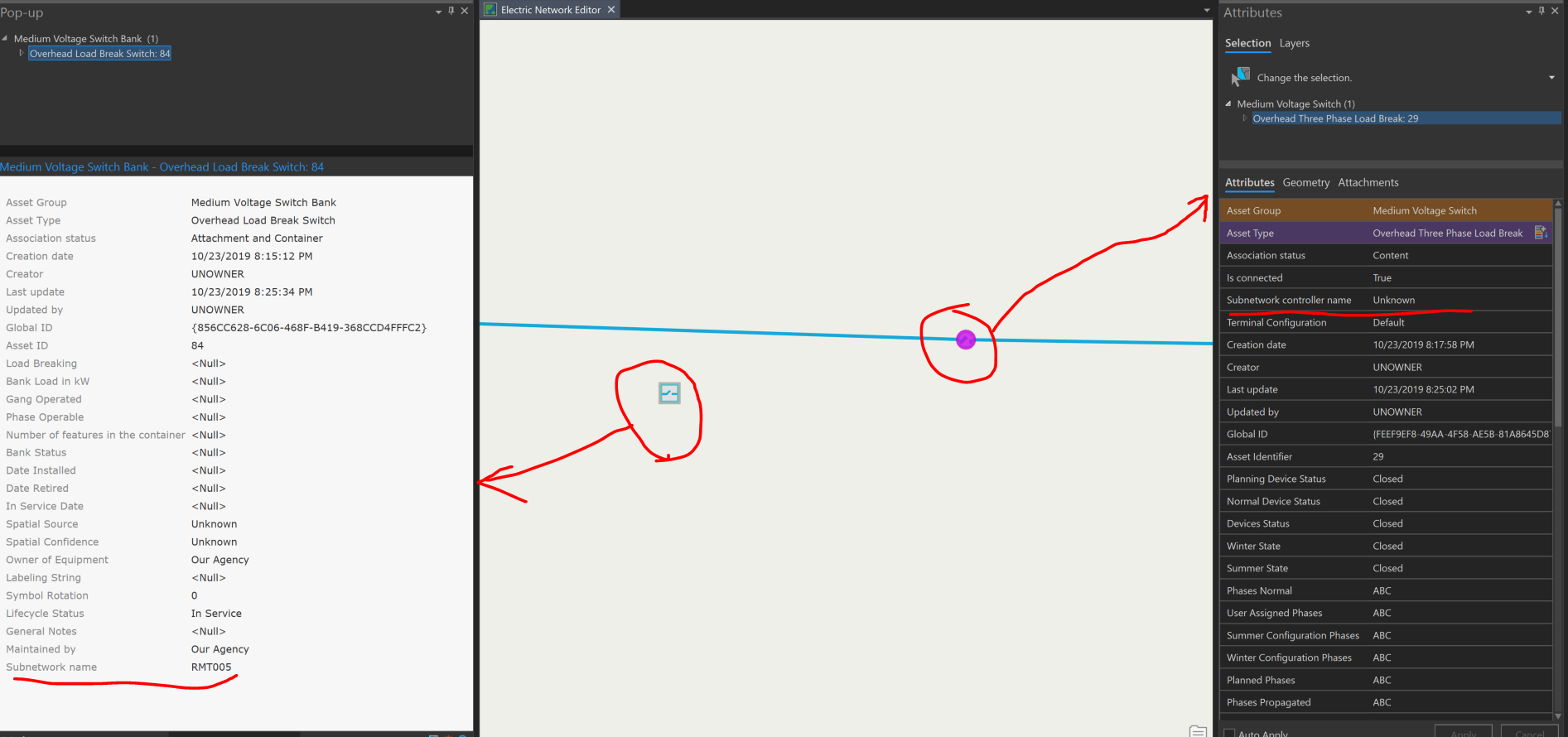

Also, we noticed that only the Assembly has an attribute for "Subnetwork name" but not the Device inside (see picture below)

PaulLeBlanc1
Subnetwork name is different than subnetwork controller name. The latter is only populated for Devices that have been enabled as controllers.

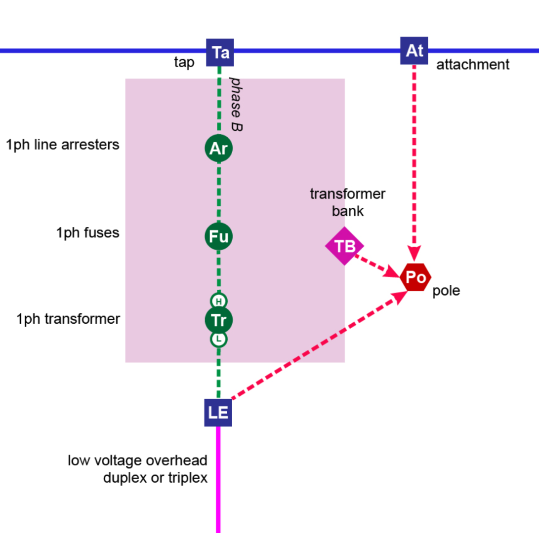

JohnAlsup
Hi Billy.  The purpose of the Assembly feature is to allow for a single point representation of multiple items.  In cases where you have a three phase fuse and you want to be able to operate the fuses by phase, you must have one device (fuse) per phase.  That gives you three fuses (devices) and two line end (junctions) where you really only want to see a single fuse symbol.  All of the device and junction features are then put in to the fuse assembly feature.  Now can you represent the three phase fuse as a single device, sure, but you will not be able to open a fuse on a single phase.  This may not matter to you, but to others it will.  When I worked a power company, we had many cases of switches and fuses where not all phases were operated the same way at the same time (mixed open and closed).  Also, again, if you need to have the case I have described, then you would want to use the assembly.  In that case, do you want your users to have to know when to work with an assembly vs a device?

I suppose you are referring to this scenario:
I understand the consistency aspect. It possible that you need to operate a single fuse like you mentioned but I guess at the end it's a matter of how close you want to model the devices in the field versus the added work needed to create and maintain such a model.
