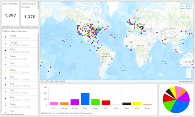

  1. Favorite Color dashboard
    This is a relatively simple dashboard, but is included here as it was the example used above. It does have some interactions between the chart and map.

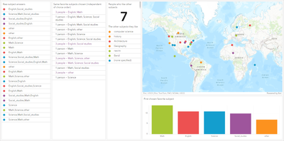

  2. Favorite subject dashboard of multi-select Survey123 data
    This dashboard takes multiselect (comma-delimited) Survey123 data and uses data expressions to examine the first choices as well to examine the sets of choices made without caring what order they were made in. It also uses Arcade to format list displays and colors, and filter to restrict the data include in another list and an indicator.
    view it live | make your own copy

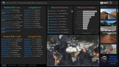

  3. Esri UC 2021 Virtual Run/Walk/Bike leaderboard
    This dashboard has lists with colored icon shapes and colors set based on data attributes, includes links in the list to additional information, and makes a list of pictures.
