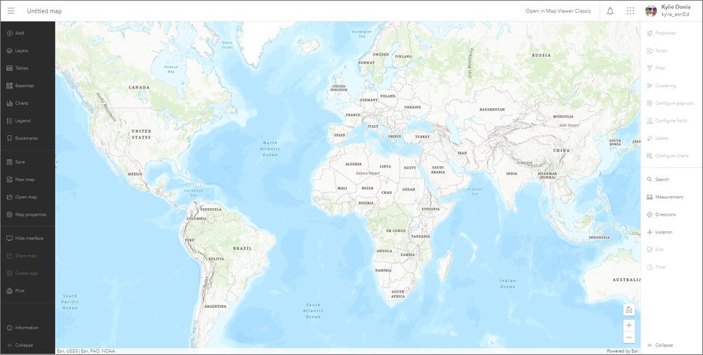

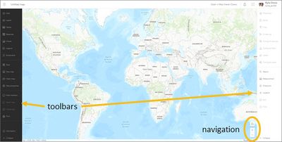

In the new Map Viewer, the toolbars are to the sides of the map, the left toolbar is a dark gray, and the navigation controls are in the lower right:

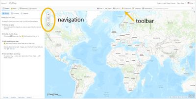

In Map Viewer Classic, the toolbar is above the map and the navigation controls are in the upper left:

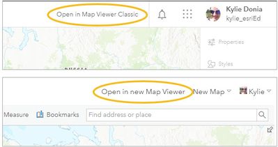

You've opened a map, and you realize you'd rather be in the other map viewer. It's easy to switch between them! Click "Open in new Map Viewer" or "Open in Map Viewer Classic" above the map.
Tip: At smaller screen widths, "Open in Map Viewer Classic" moves into the menu accessible in the upper-left corner of the new Map Viewer.

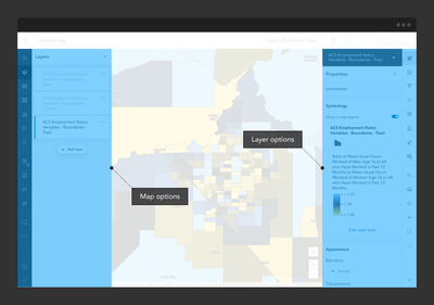

The first thing you'll notice when you open the new Map Viewer is that the tools have moved (or maybe its sleek, dark modern look). The tools are now divided into two toolbars on the sides of the map. On the left is the gray Contents toolbar with tools for working with the map and its contents, such as adding layers, changing the basemap, or opening a different map. On the right is the Settings toolbar, where you'll find tools and options, and where you'll set up each layer (including changing style and authoring pop-ups).
