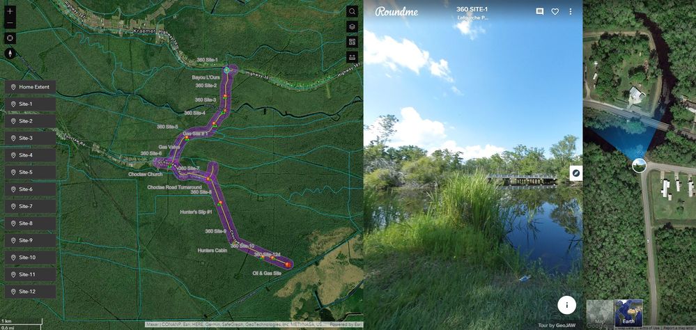

On another note, I've successfully used "Tome Bakers" 360 Workflow successfully with the 360 Virtual Tour Vendor - "RoundMe." RoundMe has one of the best features for Mapping Nerds - The side-bar pop-out Maps (either Google or Custom). My App looks like this (work in progress):

@Scoutpro36 - when you say custom map for RoundMe, can you load in an Esri Web map/app as the base? There's not much helpful information on their website regarding the custom maps besides a Revit rendering. I personally use Kuula as my hosting platform. So much cheaper and I have 100's of tours loaded on there for 1 flat fee.
Cheers - GIS Mike
Scoutpro36
You can not add a custom map service to RoundMe. I wish! It's simply and image file. How I get around this somewhat is to to create a basic layout in ArcPro with a large paper size (for resolution). export and upload that image as "custom" map to RoundMe, then manually place the RoundMe Portal Points on that image/map. it gets the job done..

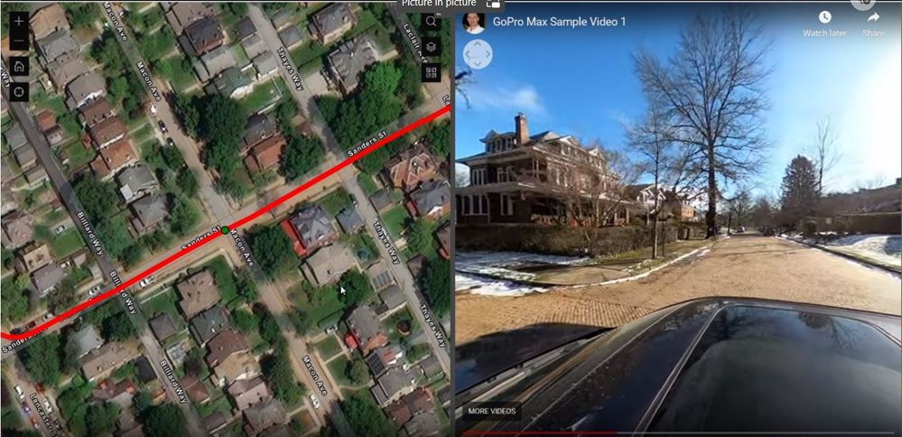

  1. GeoTube for ArcGIS. This tool seamlessly integrates a YouTube video player directly within ArcGIS Experience Builder.  GeoTube allows users to watch YouTube videos (2D or 360) within the web map while simultaneously displaying the associated location, visualizing the video path, and observing the playback location as features on the map. This enhanced user interface provides a comprehensive and intuitive understanding of the spatial relationship between videos and their corresponding geographic locations. You can learn more about GeoTube here: https://www.nodeology.net/geotube/.Visualize in YouTube. Analyze in ArcGIS.Visualize in YouTube. Analyze in ArcGIS.

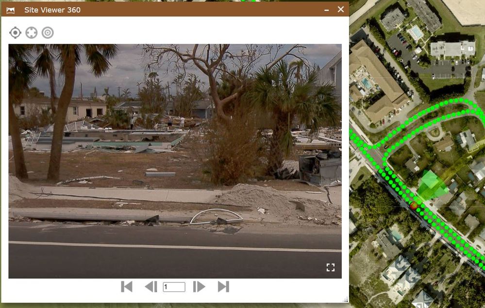

  2. SiteViewer 360 for ArcGIS: By capturing your site with a 360 camera, you can immerse yourself in panoramic views, enabling detailed analysis and exploration from every angle. ArcGIS Online 360 demos are available, featuring imagery of Hurricane Ian, Pittsburgh Steps, and Rails-to-Trails, at the bottom of this page:  https://www.nodeology.net/site-viewer-360-for-arcgis/.  Hurricane Ian 360 imageryHurricane Ian 360 imagery

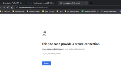

@ClarkSelby  These look really interesting. Just a heads up - when I try to view the links, the website crashes and is blocked by multiple firewalls! Is this official ESRI software?
Could you send the link to the applications with the esri.com URL? Thank you!

Hi @SaraJL ! Thank you for your interest, I'm glad to hear that. These 360 tools are actually ArcGIS widgets, and I'll be creating an ESRI Marketplace listing for them later this week. They are designed to work seamlessly in both ArcGIS Online and Enterprise environments.
I apologize if the website links didn't work for you. It's important for me to address this issue and ensure everyone has a smooth experience. I appreciate you bringing it to my attention, as I have no idea how many others might be facing the same problem. It is working for me.  In the meantime, I can provide you with direct links to the ArcGIS Online demos:
  1. Pittsburgh Steps & Westmoreland Heritage Rails-to-Trails: Site Viewer Demo (nodeology.net)
  2. Hurricane Ian: Site Tour 360 (nodeology.net)

Hey @SaraJL! Our SSL certificate is valid so my guess is this might be related to your browser's cached SSL certificate. Your browser might be relying on a cached version, which can cause the error message to appear. To fix this, I recommend following the steps outlined in this helpful article: https://ventraip.com.au/faq/article/clearing-the-ssl-state-in-your-web-browser/.
In the meantime, if you'd like a quick demo, I'd be more than happy to share my screen with you! Just drop me an email at clark@nodeology.net, and we can arrange a time that suits you best. I'm usually available after 10:00 am (New York time).
