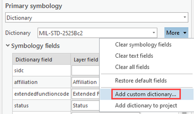

  3. Configure the layer with a web style as opposed to the desktop styles ArcGIS Pro provides by default. To specify a web style, navigate More > Add custom dictionary… and then follow the appropriate set of steps below:
    1.  ArcGIS Online: In the Add a style file window select the style that corresponds to the military symbol standard used in the layer. For use in web applications be sure to choose the latest version.
      1. Under Portal select ArcGIS Online.
      2. Search box - owner:"styles_esri" type:"Style" to narrow the results down to the military dictionary web styles provided by Esri.
    2. ArcGIS Enterprise: You may have to publish a military dictionary desktop style (released with Pro) as a web style if it is not already available. To do so, follow the steps below:
      1. Symbology pane: First choose the symbol standard you want to publish in the Dictionary drop down (if it’s a custom style, you’ll need to first click More > Add custom dictionary and browse to your custom desktop style).  Then click More > Add dictionary to project. The style should now appear in the Catalog pane.
      2. From the Catalog pane, expand Styles, right-click the military style and select Share as Web Style. This will create a new portal item in Enterprise, which you should now be able to search for and add in the Symbology pane as in Step 3a

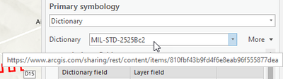

    3. If you hover over the Dictionary you selected, you should now see a URL indicating you are in fact using a web style (if a desktop style is selected in the drop-down, just the name of the style is displayed when hovering):
