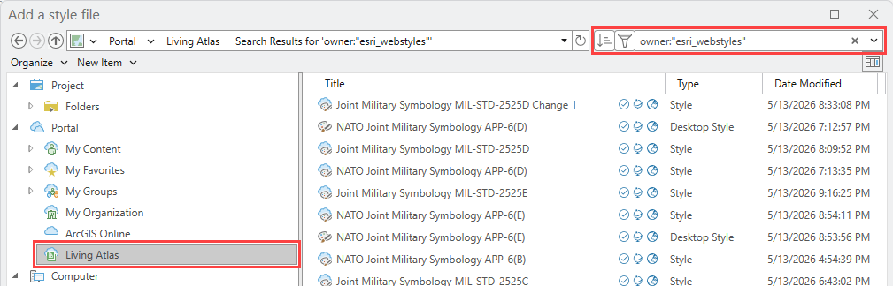

- ArcGIS Online: In the Add a style file window select the style that corresponds to the military symbol standard used in the layer.
- Under Portal select Living Atlas.
- Search box - owner:"esri_webstyles" to narrow the results down to the military dictionary web styles provided by Esri.
- ArcGIS Enterprise (11.3 or newer): In the Add a style file window select the style that corresponds to the military symbol standard used in the layer.
- Under Portal select My Organization.

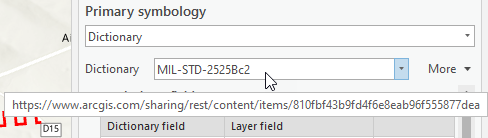

- If you hover over the Dictionary you selected, you should now see a URL indicating you are in fact using a web style (if a desktop style is selected in the drop-down, just the name of the style is displayed when hovering):
