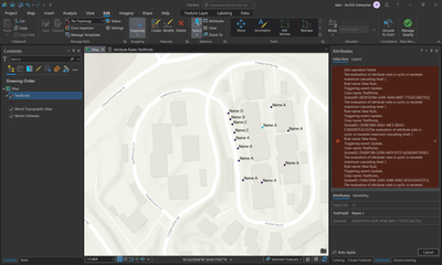

Any thoughts on this issue? Calculation works and does not work depending on number of features.
Seems this user is using your code and is running into an issue. I can replicate this issue.
@Aнастасия88
~Jake
Aнастасия88
Hi Jake, appreciate for your follow up regarding the problem that I have come across.
I still have not been able to figure out what the cause is. Hope someone will find a solution.
