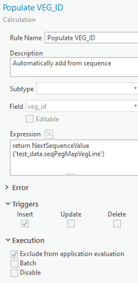

@PhallyGNP  to expand on Xander's good answer and the linked documentation, if you want to go down the "sequence as unique ID" route you need to create a database sequence (and will need rights to do so)  in the schema the dataset is in.
e.g.
CreateDatabaseSequence(Connection.sde, MyNewSeq_name, {seq_start_id}, {seq_inc_value})
where optionally start_id is the start number and inc_value is the increment.  If you have no existing values you want to use, these can be omitted.  In my work we are often importing/migrating existing incrementing IDs/sequences, so we absolutely do not want to overrun sequences and reuse IDs.
Pair this with a calculation rule as Xander mentioned.  Here's a simple example to get you started:
Note!  In this case Exclude from Application evaluation must be enabled  for reasons which I hope are obvious.  This case is for a persistent ID that does not change through the life of the feature.  If you wanted a unique ID for every change, tick trigger on Update as well.
Finally it's also worth mentioning (reviewing your original question) that Pro supports Add GlobalID which is a unique ID generator completely managed by the system.  You don't have to do anything with it and it requires no rules or Arcade. It Just Works if uniquely identifying features is what you're looking for, don't need to match/customise existing sequences and don't care what the ID is or looks like.  (It'll be a UUID which is like  a Windows GUID and look a lot like "0fa8df96-4742-11ec-81d3-0242ac130003")
