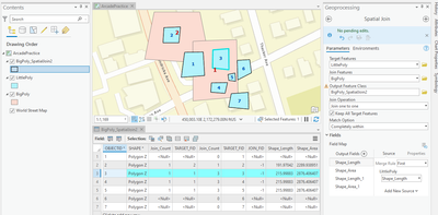

If you check:
That the two input layers are in the same spatial reference,
That polygons in GT_10_Acre_File_Merge actually do fall completely within the bounds of the Geogia_Counties_Single_Part polygon file and;
That both files do not have coordinate geometry errors.
and it all checks out (and I suspect it will) I would try using the one-to-many option.
The resulting Spatial Join file will have County Polygons showing one row for each 10_Acre_Merge_Polygon that falls within it.
If everything checks out and this doesn't work then I can't fathom why no results.... maybe try switching up you inputs for example below show all of the smaller polygons that are completely within a larger polygon.

To me, if you want to join the 10_Acre_Merge_Polygon (join) to the County Polygons (target), you should select one-to-many, because multiple 10_Acre_Merge_Polygon (join) features may be found to have the same spatial relationship with a single County Polygon (target feature).  Yes, I would suggest changing "completely contains"  to "intersect".
