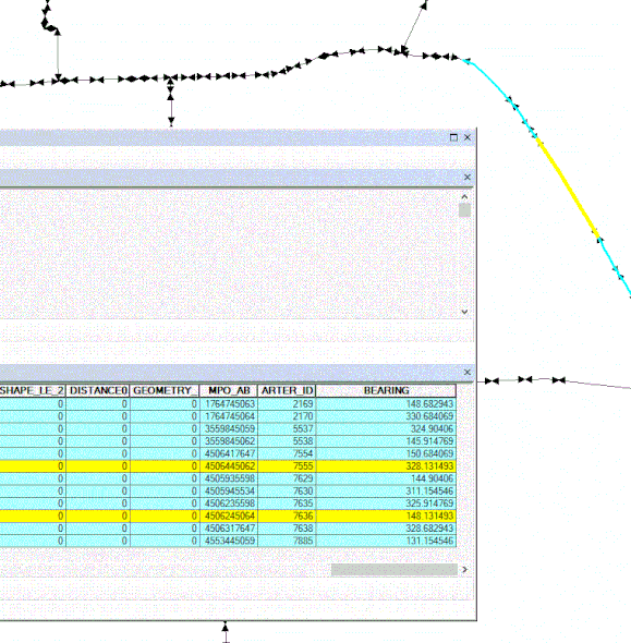

Thanks for your reply. I'm not quite following.  I added the Bearings field.  When you say use the geometry field in Find Identical I take it you mean the Shape field?  I did so and have the list of duplicates.  I can relate that result back to the line file and select all the duplicates, but how are you suggesting I limit the selection to only the lines on top of others using the bearing?  I added a screen cap of a small selection if that helps. These lines are all stacked. The lines in yellow show one example of two duplicate stacked lines.
