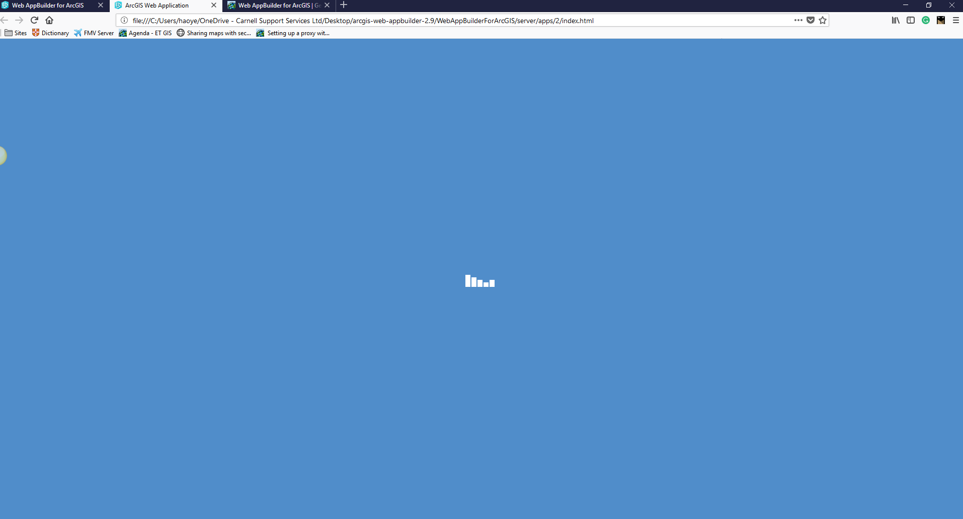

I am trying to deploy an app downloaded from WAB (version 2.9) to my local computer and I have met this deployment problem.This may be old thread but I am still strugging to troubleshoot it to get idea to the solution. So please bear with me to ask again.
My problem is I cannot open the index.html file from the source folder and view it on my browsers. As shown by pictures the app keeps loading with a white box in a blue background and there is no maps. I think I follow the configuration steps provided by Esri except for the Proxy, but I think I do not need to set up the proxy configuration right now as I have not refered any provate resources but only a public tile map for Esri (see screen).  It is strange because I can remember when 2 days ago it is working when I click the index.html under
I can open it in WAB with editing function
I cannot open it under server/app as well as in downloaded source code, keeping loading, and when I host it in IIS, it is the same.
It is normall if I open it in WAB rather than clicking the index.html file to view it in browser.

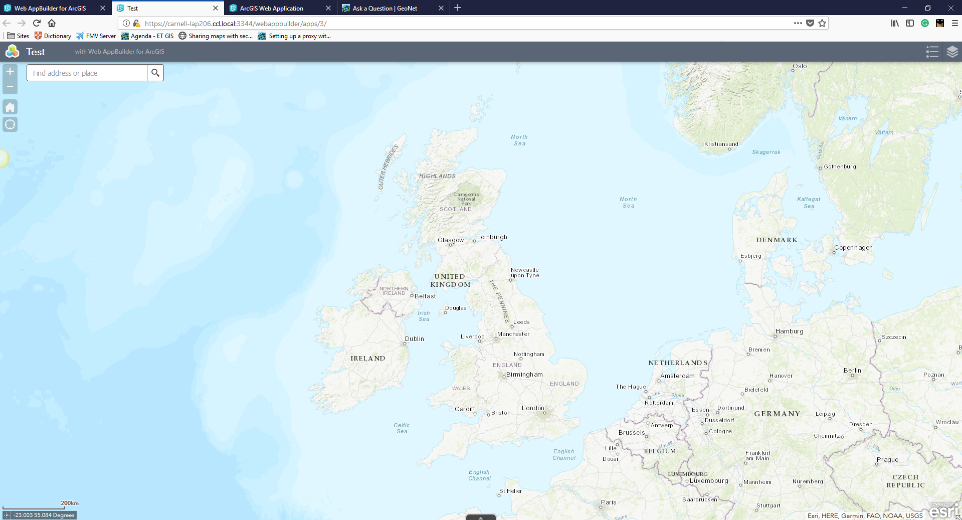

HaoYe1
I think it should be the security issue, when I change to Node to host the web and it is working now.
RobertScheitlin__GISP
MVP Emeritus
Hao,
  WAB Dev uses NodeJS as a web server and does not care about IIS. So it working in WAB Dev has nothing to do with your misconfiguration of IIS. I still think you need to change the enabled protocols on your IIS web app.
