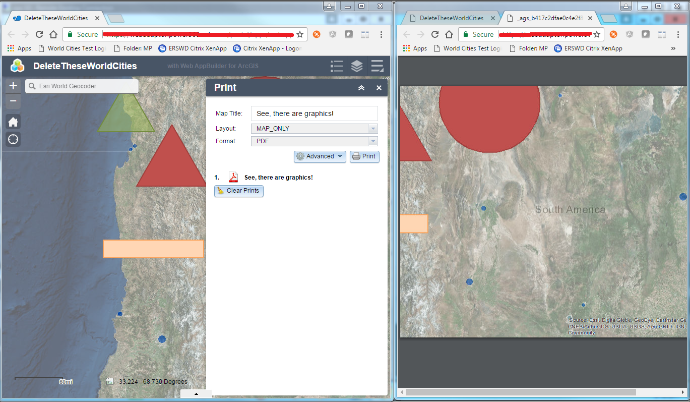

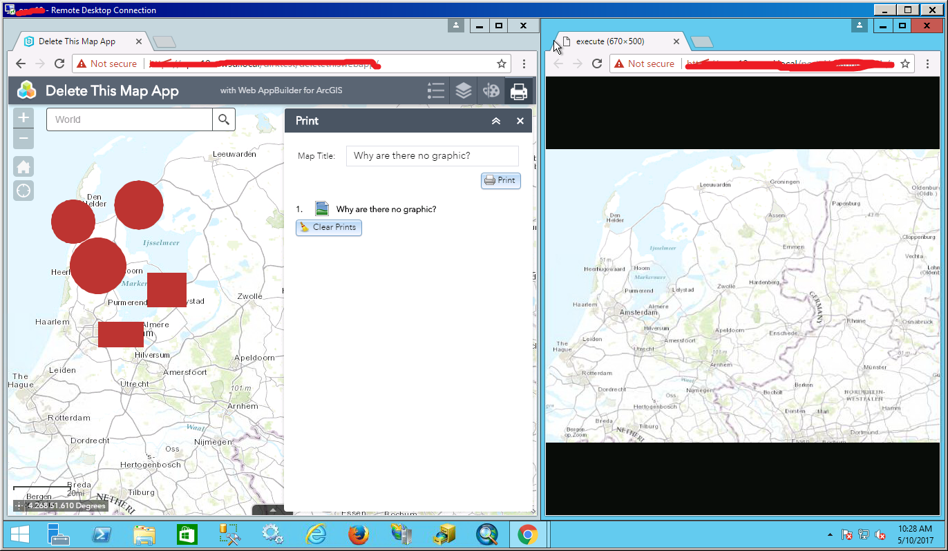

The pic below shows the issue: I have an app I configured in the WAB that includes a Draw widget and a Print widget. When I draw graphics on the map, then use the Print widget to generate output, the graphics that I drew are not included in the output.
I verified that this is not a WAB issue. This example above is from  a client site. The example below is hosted at Azure. Note that the graphics are included with the print output.
What's up with that?

Problem solved: I had the wrong URL for the print service. This works and solves both issues: https://webadaptor.mydomain.com/arcgis/rest/services/Utilities/PrintingTools/GPServer/Export%20Web%2...

Dirk,
  Do you have a proxy setup and configured in your WAB app. When you have graphics on the map the exportwebmapjson can get quite large and require a proxy to use POST instead of GET.
DirkVandervoort
Nope. I had the proxy set up correctly, so that's not it.
What's interesting/strange - although maybe not related - is that configuring the print widget at this particular site doesn't give me the option to specify the Default Format and the Default Layout.
